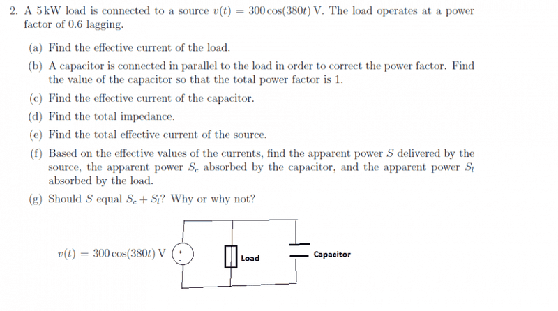

Circuit schematic with source v(t) = 300 cos(380t) V driving a parallel load and a capacitor, next to a textbook problem on load power factor correction.
I added a circuit that I drew in microsoft paint to add a visual. Sorry for its ugliness! ;D

Since this is quite a long problem, I'll detail my thought process up until I get stuck. On the left, I have my work, and then I explain what I am doing on the right.
a) To find the effective current over the load:
P = (1/2)*v*i*(pf) Solve for i... (pf = power factor)
i = 2P/(v*pf) Then substitute in values...
i = (2*5000)/(300*0.6)
i =55.56 Now I have to divide the current by the square root of 2 to get the effective power
i = 55.56/sqrt(2)
i = 39.28 A rms This is the answer I get for a) and I have confirmed that it is correct.

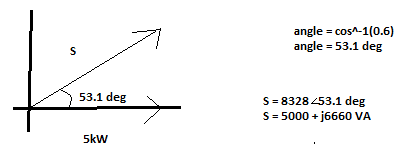

b) Now I have to correct the power factor from 0.6 to 1 by adding a capacitor in parallel with the load.
Power triangle diagram with a horizontal 5kW leg, an apparent power S arrow at an angle of 53.1 degrees, and the values S = 8328 ∠53.1 deg and S = 5000 + j6660 VA.
PF = 1
theta = cos^-1(1) Finding the angle when the PF is 1...
theta = 0 degrees
Qn = tan(0deg) Using the new power factor, I'm finding the new reactive power
Qn = 0
Qc = -(Ql - Qn) We can find the reactive power of the capacitor by subtracting Ql and Qnew
Qc = -(6660-0) Substituting in values...
Qc = -6660 VAR This is the reactive power of the capacitor
Q = V^2 / Z Now we use the reactive power of the cap to find its impedance...
Z = V^2 / Q Solve for Z
Z = (300^2 / -6660) Substitute
Z = -j13.51 This is the impedance of the cap
Z = -j/wc Now we have to find the capacitance...
C = -j/wZ Solve for C
C = -j / (380 * -j13.51) Put the equation into a calculator...
C = 194.8 uF I have no way of confirming if this is right, but I'm pretty confident that it is!
c) Ok... this is where things start to get a bit shaky...
So in order to find the effective current of the capacitor...
V = I * Z
I = V / Z Solve for I...
I = (300) / (-j13.51) Substitute...
I = j 22.2058 Then I have to multiply this by 1/sqrt(2) to get the effective current...
I = j 22.2058 / sqrt(2)
Ieff = 15.7 A This is the answer I get; however, I know it is wrong. It should be twice that...
Ieff = 31.4 A This is what the answer is supposed to be. I am unsure why I get half it.

Ssource should not equal Scap + Sload because capcaitors only absorb reactive power (Q) and the Ssource is not a complex number. However, I'm conflicted on this reasoning because isn't it also the case that the power delivered should be equal to the power absorbed?
OK... So it is a pretty long problem and I appreciate it if you have stuck through the whole thing. I don't know exactly what is wrong, but I have suspicions:
1. I am unsure as to why the answer I got is exactly one half of the actual answer... perhaps I dropping a 2 somewhere? I know there are a whole bunch of new equations that get thrown around in AC Power, so I may have gotten a formula wrong.
2. For part c), I really don't think I am supposed to substitute the I effective in for I, but I don't know what I would be.
3. And then everything from part d) and on I think just stems from the previous wrong answers.
Again, thank you to all those who have been helping me through circuits! It's almost over! (^_^)
The capacitance value is incorrect.
Z = (300^2 / -6660)
You have taken the peak voltage in this formula. It should be RMS. This is where you dropped a factor of 2.
Thanks for your response!
I fixed the voltage; changing it from peak to rms...
Vpeak = 300 v
Vrms = 300 * (1/sqrt(2))
Vrms = 212.13 v
Then I used this number to solve for the impedance of the capacitor...
Q = v^2 / Z Solve for Z...
Z = v^2 / Q Substitute...
Z = (212.13^2)/-6660 Plug into calc...
Z = -j6.75 ohms Fixed impedance
Then I use the impedance to find the capacitance...
Z = -j / (wC) Solve for C...
C = -j / (wZ) Substitute...
C = -j / (380 * -j6.75) The "-j"s cancel out...
C = 1/(380 * 6.75)
C = 390 uF Fixed Capacitance...
