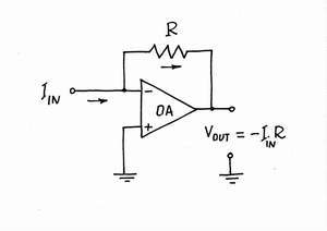

You didn't provide us with a schematic or a sketch so it's not very clear what you're talking about, is this essentially what you have?
If so, it's going to take an impractically large resistance value to convert a mere few pico amps to suitable range of say 1-5V.

@jegues
its pretty much the same...but the output is not grounded

d.sonali20 said:
@jegues
His sketch does not ground the output of the opamp. It represents an opamp output voltage that is referenced to ground (like the load resistance is between the opamp output and ground). That is standard notation.
