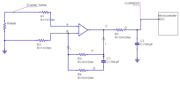

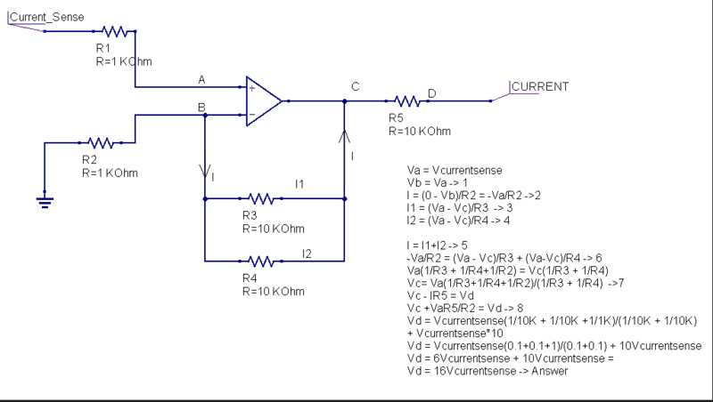

I want to solve the below current sense op amp circuit,
Are the calculations correct? As of now i modified the circuit by removing the capacitors, i will add them once the above circuit calculations are correct, as next step.
MENTOR Note: moved here from EE forum since its HW hence no template
sign error in steps 3 & 4, or step 5. I didn't look at the rest of it.
The answer will be ## Vc = (1 + \frac{R3||R4}{R2})Va = 6Va ## .
The output will depend on the load applied. I'm not sure why R5 is present, but there's probably a good reason?
Yes thank you very much for correction
With R5 does the current increase 16 times compared to 6 times without R5?
I don't understand is why the current I flows from C to B, from output to input, should it not be from B to C?
This is not a standard current sense circuit, it is a non-inverting voltage gain circuit,
No. R5 makes a voltage divider with the load resistance (##R_L##), which isn't shown. So ##V_D = (\frac{R_L}{R_L+R5})V_C##.
If the input voltage is positive the output will also be positive. The current I will flow from C to B because ##V_C>V_B=0## . It flows the other way if the input voltage is negative.

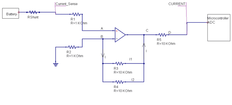

To make sense of this more info is needed. The left side of R1 cannot sink or source any current so I'm guessing there is a shunt resistor and the left side of R1 is the high side of the shunt. The other side of the shunt is grounded since the left left side of R2 is grounded.
This is the circuit that i am using, what does left side of R1 cannot sink or source any current mean? how to know that?
DaveE said:
No. R5 makes a voltage divider with the load resistance (RL), which isn't shown. So VD=(RLRL+R5)VC.
Why R5 is not considered load resistor? or how to know that there should be a load resistor? Please advise.
Because R1 is connected to the input of the opamp, and ideal opamps have infinite input impedance...
Because the way you originally drew the circuit it wasn't connected to anything so there was no current flowing through it. "Load resistor" isn't a precisely defined term, but it is usually the resistor at the output of a portion of the circuit that determines the current (or voltage) that that circuit provides given it's output state.
PhysicsTest said:
This is the circuit that i am using...
This circuit doesn't do what you described. Virtually no current will flow from the battery. You are measuring the battery voltage and multiplying it by 6x. That's assuming your op-amp can output that much voltage, which it probably can't.

There is a tiny little "-" sign after the "Battery" label, so it looks like that is the grounded battery return net and the outside connection of R1 is indeed a low-side current sense voltage net. This would have been much clearer if the OP would have added a ground symbol to the Battery- net (but, well, you know). :wink:
R5 looks like a clear circuit error, unless the uC requires it for some reason at its ADC input. And the duplication of R3 and R4 is also a clumsy circuit error (since it is easy to get the desired amplification ratios with just 2 resistors instead of 3).
@PhysicsTest -- please post the whole circuit schematic for the whole application, and describe what you are trying to do. You should be able to tell that this is pretty frustrating for us trying to help you with so little information to go on. We can tell you are new to circuits, and we want to help. But when you post only snippets of what you are working on, that is a bad combination with your current level of understanding. Thanks.

R5 and C2 form a lowpass filter into the ADC. It may be there for noise reduction, or to better match the sampling frequency of the ADC. You can look up "anti-alias filter" for more information.
C1 in the feedback loop also provides some filtering. Have you ever used LTSpice or other Spice simulation packages before? That may be the easiest way to visualize the filter functions going on in this opamp circuit...

If you just think about the basics of that feedback circuit, you can see that it is setting 2 different gains (in combination with the input resistor R2. At low frequencies C3 is an open-circuit, and at high frequencies C3 is a short circuit. So the low-frequency and high-frequency gains are different. Quiz Question -- what are those two gains?
Sorry there is also a capacitor between R1 and R2 of 104pF.
Across the two opamp inputs? That's okay, that's just another lowpass filter formed with the two differential input resistors.
