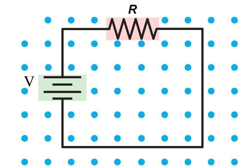

The circuit shown in Figure encloses an area of 33 cm2. The magnetic flux increases steadily from 0 T to 0.5 T in 5 ms. What is the current in the resistor during this time? (V=18 V, R=30 Ω)
E = A * (B/T) = 0.0033 * (0.5/0.005) = 0.33 V
I = E/R = 0.33/30 = 0.011A
What am I doing wrong here??
can anyone help me with this pretty pleaseeee...
sorry the picture is SO big!
