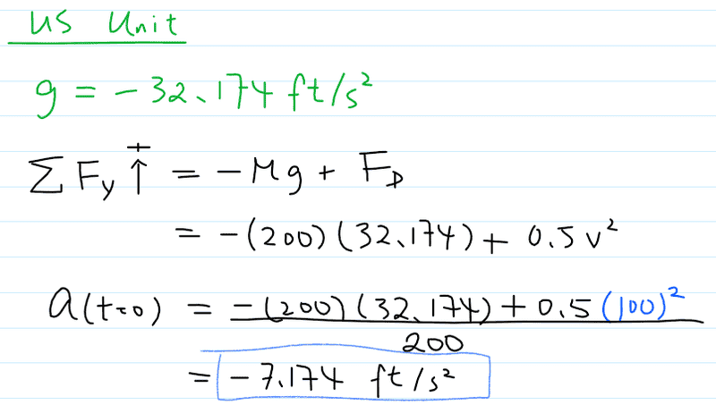

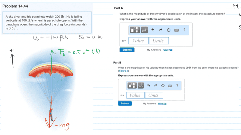

nysnacc
184
F=ma
Sum of force
Not sure if my a is correct, but actually, I need to have it in imperial (US) unit,[/B]

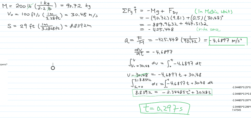

You cannot assume a constant force in the second part. The force depends on velocity, which is changing.
but first part is good? what should I do with the force then?
No, the first part is not ok either. According to your computation, the sky diver will crash into the ground with a velocity larger than 30 m/s. This does not seem like a very good parachute. Hint: Units are important. Always convert values of the same type of quantity to the same units!
Edit: The problem is also not well stated. It states that ##F = 0.5 v^2## (in pounds) but fails to tell you what units this requires ##v## to be specified in.
this is my updated value, as I was supposed to use US units thanks for pointing that out :)
No this is not correct either. Look up the definition of lbf vs the definition of lbm. Your sky diver would still accelerate from a velocity of 30 m/s and crash into the ground at a higher velocity. (This hurts!)
Also, please stop using images in your posts. It is impossible to quote parts of them and they do not always appear well on mobile devices etc. There is a perfectly viable way of writing equations in LaTeX in this forum if you want more advanced formulas than what can be written in plain text.
Umm... what's wrong with my initial equation?
Absolutely! It seems crazy to give a formula where the units are defined for only one of the variables. Of course I'm not accustomed to USC units, so perhaps ft and sec are implicit if F is in pounds?
Surely the proper way to give such a formula, is to say F=kv2 then give the value of k with units.
Then k = 0.5 lbf sec2 ft-2 for honest Americans, or for us foreigners k = 24 N sec2 m-2
I would not bet my money on this. Without giving too much away, using this would give a rather large g-force on the sky diver (higher than any I could find referenced for sky diving in a quick Google search). If the velocity ##v## is intended to be in m/s, you instead get a rather low value.
On the other hand, the option k = 0.5 lbf s^2/m^2 also gives a large terminal velocity (roughly 20 m/s) and k = 0.5 lbf s^2/ft^2 gives roughy 7 m/s. Both are high velocities. 7 m/s would correspond to free-falling from roughly 2.5 m height.
