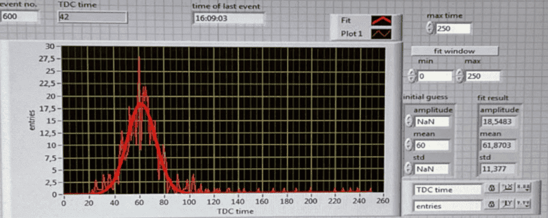

Hello everyone. I have just complete an experiment calculating the speed of a muon. I got it to 2.6E8 m/s, however I know that they are created at close to speed of light to be able to get down to Earth's surface in their short lifespan. This speed could not have been its initial speed, as it with it's current speed could not get down to Earth from 15km. It most have lost some energy and therefore speed going though the air. I would love to calculate the amount of energy it has lost, is there a way to do that ?
In this experiment we had to show how naturally created muons in a height of 15km could get down to Earth and get detected when they only have a lifetime of 2.2μs
The data and how i calculated the speed is below.

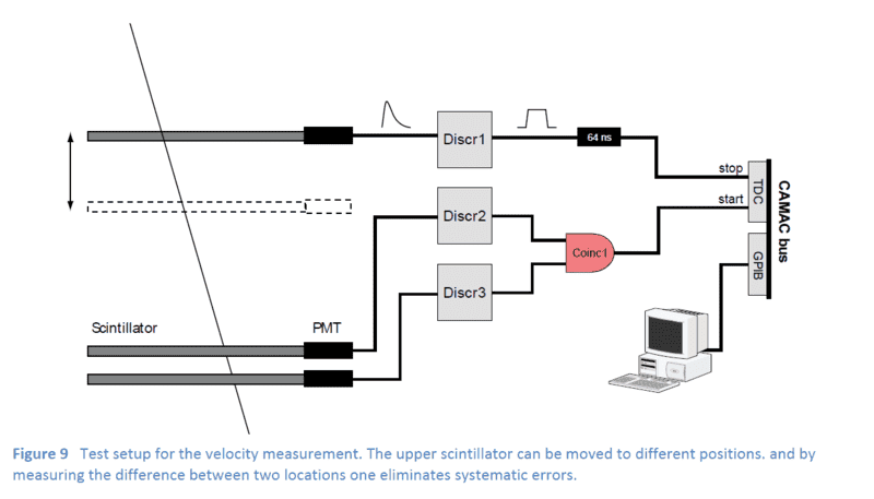

We used two scintillator detectors.
We first calibrated the TDC module on our computer. Here we got the linear relationship to be
##y=0.45443ns*x + 13.471##
In the first measurement on of our detectors were raised ##d=1.91m## above the ground, with an uncertainty of ##\sigma _d = 0.01m##. We detected 600 events. We got the mean to be ##M_1 = 61.8704## and the uncertainty of ##\sigma _1 = 11.377##.
In the second measurement we put the two detectors on top of each other as to get as many events as possible. We got 901 events. We calculated the mean to be around ##M_2=77.7572## and uncertainty to be ##\sigma _2 = 8.14527##.
With this information we calculated the average speed of the muons. $$v= \frac {d} {(M_2 - M_1)*0.45443E-9s} \approx 2.65E8 \frac {m}{s} $$
We then calculated the uncertainty of the speed. $$\sigma_{v}={\frac {1}{ 0.45443\,E-6\,s}\sqrt {{\frac {{\sigma_{d}}^{2}
}{ \left( M_{2}-M_{1} \right) ^{2}}}+{\frac {{d}^{2}}{ \left( M_{2}-M_
{1} \right) ^{4}} \left( {\frac {{\sigma_{1}}^{2}}{n_{1}}}+{\frac {{
\sigma_{2}}^{2}}{n_{2}}} \right) }}} \approx 9.06E6

I mean this:
Your formula for ##v## depends on the difference ##M_2 - M_1##, so ##v## is also uncertain.

We are using the time difference between detectors going off. This is our setup. So as far as i know we aren't using their decay at all

Here is what the data looks like
Given that I can't even figure out what ##M_1## and ##M_2## represent, I don't think I can help!

I assume, that in the second measurement most of the muons were not received vertically because the detectors were too close together, see in the link FIG. 10 on page 5.
In the second measurement, what was the distance between the sensors, when you put the detectors on top of each other?

they were lying on each other so i would say 0m

What time interval shows the x-axis at the second measurement?

Are ##M_1## and ##M_2## times in some unspecified units?
To my understanding, this are the x-axis values (without unit) of the maximums of the shown curves. According to the OP, one x-axis unit relates to ##0.45 ns##.

What are approximately width, length and height of the detectors?

We, used different tick times for the TDC when we got the times we tried to use linear regression on it. here we got a ##R^2 = 0.9991 ##.
The height is approx 10cm width 50cm and length is about 1.2m

Which signal does the y-axis show while the calibration?
Does that mean, that in the second measurement some (not vertically received) muons travel 130cm between detection on the left/rear side of the top detector and the detection on the right/front side by the bottom detector?
Is 1.2 m also the length of the physically active detection device in the detector box?
If yes and if they move with c, this would contribute up to 4.3 ns to ##.45ns * (M_2 - M_1)## in the formula for v.
