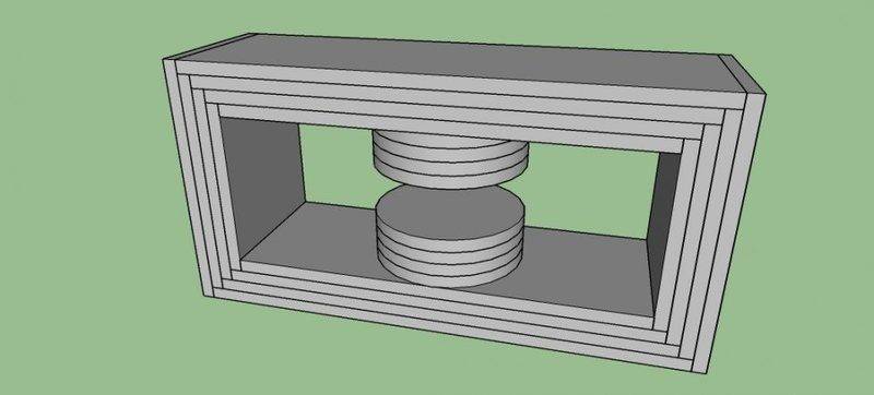

I would like to build an electromagnet to accelerate electrons into a circle (a precursor to a mass spectrometer). I would like to calculate the field strength, but I don't know how because I would like to wind it out of aluminum strap salvaged from a welder, and I can only find formulas for solenoids (and I don't fully understand how the formulas are derived, and therefore can't find the formula myself). The core resembles an E core, but with a large air gap in the center leg where the electrons (and hopefully ions eventually) will pass through. The middle leg is also round, while the others are rectangular.
I can supply plans of the core if need be.

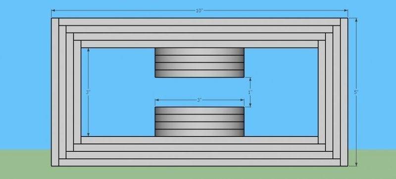

This is the core. I would like to wind the magnet such that the maximum power I would reasonably put through it would be very close to the saturation of the core.
It is made of mild steel, and is 3" deep.
The coils go around the circular parts and will be wound with aluminum strap.
The mean path should be 16" (0.41m)
The surface are the magnet is on is 3" diameter, with a 7.07 in^2 cross section.
Each outer leg has a 3 inch cross section.
Given a saturation flux for mild steel of 1.2 Teslas, I calculate the gap could be at a maximum of 1.02 Teslas.
Since the permeability of mild steel is 1.26e-4 H/m, it should have an AL value of 5.12e-5 H/n^2
I have to measure the thickness of the aluminum, and the insulation, to determine the winding density.
The cross section areas are not the same along a circulating path, so you must divide this path into pieces represented by various magnetic "resistors".
In this way you can create an electric analogy to the magnetic circuit, for example by inserting a voltage source in the airgap, representing the desired H-field
