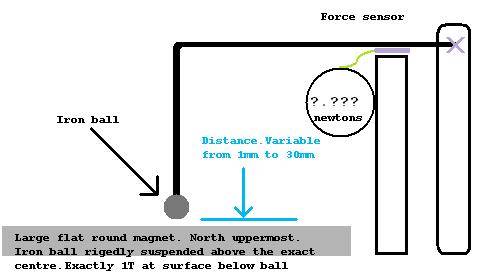

So, let's try this another way.
Diagram of a setup with a large flat round magnet at the bottom, an iron ball suspended above its centre on a pivoting arm, and a force sensor at the top. A blue arrow marks a variable distance from 1mm to 30mm between the ball and the magnet surface.
As you don't like infinite, let's say the magnet is , oh, 5m in diameter. The ball is 1mm diameter positioned above the exact center.
At the point on the surface, 1mm below the ball, the magnetic field is determined to be EXACTLY 1 Tesla. A reading Newtons (calibrated to exclude gravity acting on the ball and the pivoting arm) is taken.
The drop arm is shortened to move the ball say (say) 10mm away. Another reading is taken.
Repeat at 20mm, 30mm 40mm...
Will they be different?

Ok my bad. With an infinitely large magnet it will as near to 1T as makes no difference. Infinity >> 1mm.

Buk said:
He didn't say "virtually no reduction", nor "very little reduction" nor "an immeasurably small reduction". He said: "Exactly 1 Tesla".
Yes they will be different but the difference will still be very small.
I think the 1/r^3 law only applies when the distance is more than ten times the magnet diameter or something like that.
Buk said:
Are you saying the difference is incalculable? (Or just that you/he don't know how to calculate it?)
No I don't know how to calculate it. I suspect you might have to measure it.
For an infinite plane it is exactly 1 T. In order for it to be anything else the magnetic field lines would need to curve. But since it is an infinite plane then by symmetry they cannot curve. Therefore it is exactly 1 T.
Buk said:
As you don't like infinite, let's say the magnet is , oh, 5m in diameter. ... Will they be different?
For this finite magnet they will be different. If the magnet is short compared to the 5 m width then you can treat it as a loop of current. Otherwise you would treat it as a finite solenoid.
http://web.mit.edu/viz/EM/visualizations/coursenotes/modules/guide09.pdf
