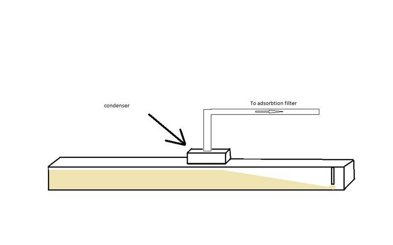

Hello, I'm having a problem calculating the final pressure before condenser. I'm calculating the pressure that builds up in a system that at the beginning has atmospheric pressure @ T=20C and is introduced with 1 mole/second of CO2(44.01g/mol) @ T=60C and 0.318 mole/second of CH2Cl2(84,93 g/mol) @ T=60C. The volume of the system is 80 m3. There is an outlet after the condenser. The amount of gases that enters the system must exit trough the condenser. So I think there should be a constant pressure at some point. The process goes for 360 minutes. I have very little understanding of gas mechanics, I would be grateful for ant help.

This problem is about gas exiting polyurethane foam during its production. The production line is sealed so all the gases are trapped inside.
Every second foam releases:
1 mole of CO2(44.01g/mol) @ T=60C
0.318 mole of CH2Cl2(84,93 g/mol) @ T=60C
The final goal is to calculate the required condenser to reclaim CH2Cl2.
the volume of the production line is 80m3
I will add diagram and some calculations that i tried soon

To do this, you need to know the pressure-drop / flow-rate relationship for the condenser. You may have to measure that.
What is that brown thing in the figure? What is that rectangular box between the big box on the bottom and the condenser?
Likes Povilas
It's foam pattern or rise. Thank you i will look into pressure-drop / flow-rate relationship for the condenser.
