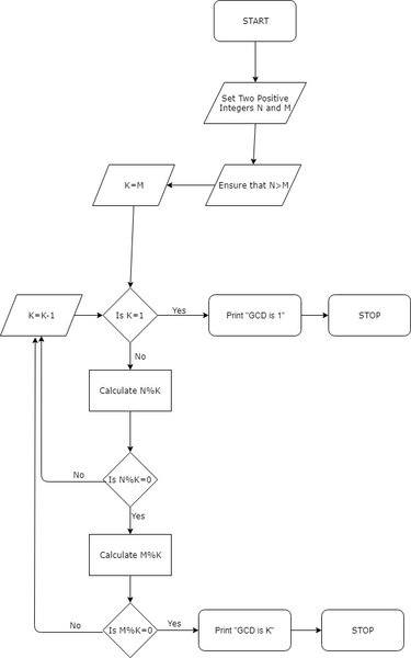

jbriggs444 said:
You are presenting these as linear sequences of lines but have mentioned a few times that they are "flow charts".
In a sequence of lines, following execution of line 10, one would expect to continue and execute line 11. This natural assumption is visible through your code where you do, in fact, assume that execution proceeds sequentially from one line to the next.
But then we come to the above code where you clearly expect the opposite. In the profession, we refer to this as "DWIM" logic -- "Do What I Mean". In real life, if you want execution to terminate after line 10, you have to say that execution stops after line 10.
Programs do what you say, not what you mean.
I see your point. But Its hard to write as a line step or introduce it like that...In flowcharts its really easy to see
The main question is I guess what happens If M>N I am confused there. Should I copy the steps I did for N>M or is there another way or just we can take as it like that and its not a desicion thing ?

Your flowchart still lacks updating of k in the loop, so if it loops once, it will loop forever.
You could have a cell in a flowchart titled: set K to the minimum of M and N and then draw a sub-flowchart that implements this step.
You might want to use labels in your pseudo-code, because renumbering when inserting steps will drive you crazy, or you could start with stepnumbers that are multiples of 10, so you can insert lines without any renumbering.
It's probably better to not use GOTO's to go to the next line in your pseudocode, and let all statements go to the next line by default. You will need and END PROGRAM statement to terminate the programm, instead of continuing to the next line.
GCD algorithms are possibly the most analyzed of all algorithms, and it can indeed be done much more efficiently, but a beginning programmer can hardly be expected to come up with anything better than you did. This seems to be a straightforward translation of the definition of GCD. Of course, googling is probably one of the most useful programming techniques, which you should also learn.
I noticed that the one that I send was wrong,
I am tired I ll try to do the next one.
This has the exact same bug that existed in your previous flowchart (the one for detecting primeness).
Try executing your code for N=4, M=2. The flowchart will claim that the GCD is 1.

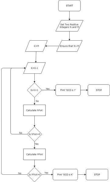

Arman777 said:
Cause when I say M=2 and then K=K-1 it gets 1 right
Right!
jbriggs444 said:
Right!
Yes, doing the increment at the end of the loop and the test at the beginning is good.
I think we can refrain from pointing out an optimization that would allow this particular termination test to be eliminated entirely. One lesson at a time.
