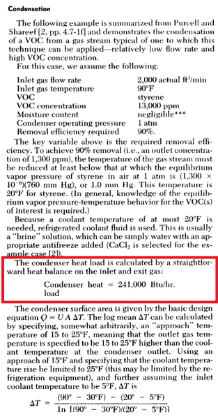

Hello everyone, I'm having problems understanding how to calculate heat load. Does anyone know what formula should i use?
I tried to calculate energy needed to cool the gases to 20 F but i need specific heat witch i don't know how to calculate.
Info in the picture.
Thank you for your time :)

It's hard work, I realize: coolant must
  1. cool the whole gas stream to 20 F (the bulk of the work)
  2. condense 90% of the styrene (a small extra term)
for a bachelor you should have formulas at hand for both of these tasks.

Read your edited first post: for the gas you indeed need the specific heat, which generally you look up (but that requires that you know what gas it is ... :wink: )
You can imagine heat needed is proportional to this ##c_p##, proportional to the flowrate and proportional to the temperature drop:$$ Q = c_p \, \dot m\, \Delta T$$

You just look it up : google 'styrene gas heat capacity' and there you are. Point is that the styrene is only 1.3% of the stuff you are trying to cool down, so you still need to know what the remainder is ...
For the condensation you need the heat of condensation (e.g. from the same source)

So let's say I have a mixture of two gases and styrene is 1.3% can i calculate Q like this:
Q=(m1*0.013*c1+m2*0.987*c2)(T1-T2) ?

That's one way. Another is to dig up Purcell and Shareef (which wasn't all that difficult :mad:) and in fact they do it all for you ! Formulas, phys props, the works ! Hideous units, but you can't have everything :wink:.
Spoiler: the 'other gas' is air ?:) !
