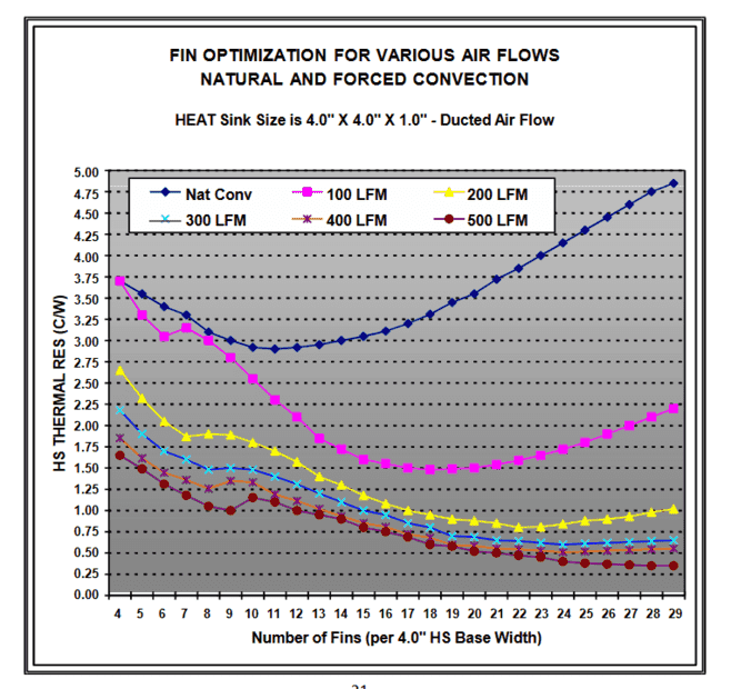

Edit/Add -- Maybe this plot from the paper is instructive:
Likes Tone L

You mean "better" than that value of 1C/W, not "greater". So you need less than or equal to 1C/W. :wink:
That is pretty hard to achieve without forced airflow. What does your enclosure look like?
