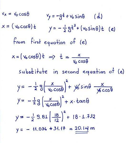

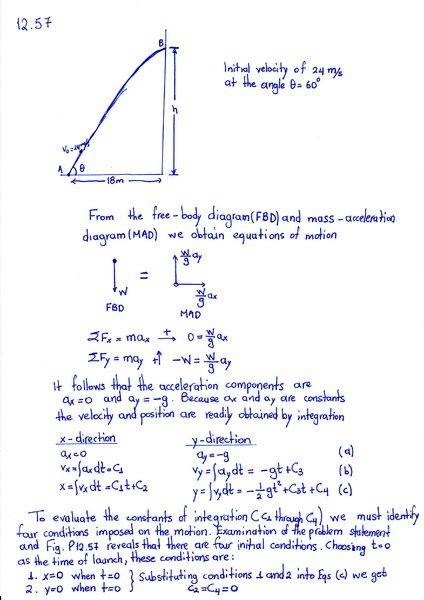

A projectile launched at A with an initial velocity of 24 m/s at the angle θ=60deg, impacts the vertical wall at B. Neglecting air resistance, calculate the height h
Here is my solution
As you can see to find height h I assumed that ##v_y=0## in the second of Eqs. (f) and solved for time.
Is this correct or should I have solved first equation of (g) to find time and then solve for y?
Then don't. There is no basis for such an assumption.
Yes, find t first.
Look at your equations labeled (e). The first equation can be used to find an expression for t in terms of x and θ. Substitute that in the second equation and you will have y as a function of x and θ. Substitute the given numbers for x and θ to find h.
