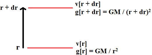

Good day,
I have a question regarding calculating the total reached height ##H## of an object that is thrown upwards with an initial velocity ##v_i##, while taking into account the decreasing gravitational deceleration ##g## with height as well.The formula would be something like:
$$v_i \cdot t - \frac{GM}{r^2} \cdot \frac{1}{2} \cdot t^2 = H$$
My problem here is that the deceleration (##\frac{GM}{r^2}##) inside the formula changes with the outcome of the formula itself, since ##H## represents the height.
My temptation is to integrate this formula but I’d have to integrate over the outcome ##dH## and not over the time ##dt##. Besides, integrating over the time ##dt## instead is risky for inaccuracy because the initial velocity might be very high and thus the object can reach in ##dt## time a very high distance in which the deceleration ##g## might change significantly.
Writing ##t## in terms of ##dH## is also not possible since it has two possible solutions for ##t## (one on the way up and one when the object is falling down).
Question: Is it actually possible to calculate the reached height ##H## with this formula while taking into account the changing deceleration ##g## over the height itself? I was able to deduce that there is another way of doing this by solving ##\frac{1}{2} m v_i^2 = GMm (\frac{1}{r} - \frac{1}{r + H})## but I was specifically wondering about my mentioned formula. I might be missing something very obvious.

Thanks for the tip, I tried formulating ##\frac{dv}{dr}##. Here it goes.
Let ##dH## be ##dr##. I concluded that ##g[r]##, which is the deceleration at height ##r##, doesn't (merely) change until the object reaches height ##r + dr##
Using this information, this means that:
$$dr = v[r] \cdot t -\frac{GM}{2r^2}\cdot t^2$$
Furthermore, the change in velocity per each ##dr## is equal to ##dv=\frac{GM}{r^2} \cdot t##. Dividing ##dv## by ##dr## should give the differential equation of the function ##v[r]##.
$$v'[r] = \frac{dv}{dr} = \frac{\frac{GM}{r^2}\cdot t}{v[r]\cdot t - \frac{GM}{2r^2}\cdot t^2} = \frac{1}{\frac{v[r]\cdot r^2}{GM}-\frac{t}{2}}$$
This means that I can get ##t## from:
$$t=2 \cdot (\frac{v[r] \cdot r^2}{GM} - \frac{1}{v'[r]})$$
Does this make sense so far?
This can't be right - you've got an infinitesimal on one side and a finite quantity on the other. Either the left hand side has to be dr/dsomething or the right had side needs a dsomething.
In any case, you're working far harder than you need to. Are you familiar with the chain rule? Can you use it to express dv/dt in terms of dv/dr?
You're right, I missed this. The dsomething is exactly what I'm struggling with since there are too many variables in the function that are also dependent on each other. Shouldn't the time ##dt## corresponding to a distance ##dr## be like:
$$dt=\frac{dr}{\frac{1}{2}(v[r] + v[r +dr])}$$
And:
$$\frac{1}{2}dv = \frac{1}{2} \cdot v'[r] \cdot dr$$
So if I multiply these two functions together, I should get ##dr##? I'm deliberately multiplying the half of ##dv## with ##dt## for getting ##dr##, since the deceleration ##g## is considered constant within a distance ##dr##; in that case the distance ##dr## is therefore the mean of ##dv## multiplied by ##dt##.
I'll look into that and see what I can get out from it.
Sorry, but could someone please verify my mentioned formula's in my above post #10? I want to make sure if I understand these relationships correctly.
I don't follow what you were trying to do. I was just going to write $$\frac{dv}{dt}=\frac{dv}{dr}\frac{dr}{dt}=\frac{dv}{dr}v$$That ought to be fairly straightforward to integrate.
