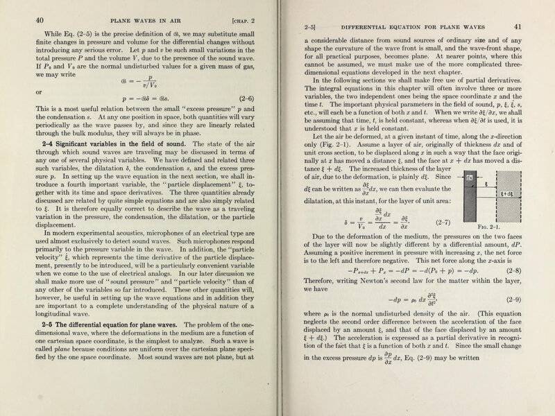

Here are a couple of pages from Randall

Re Randall: Could I ask you to show the derivation of the bulk modulus
from your extract please? Perhaps post the relevant section of Chapter 2?
And could I ask if nonlinear acoustics is a phenomenon of an ideal gas?

Re Randall: Could I ask you to show the derivation of the bulk modulus View attachment 337692 from your extract please? Perhaps post the relevant section of Chapter 2?View attachment 337690

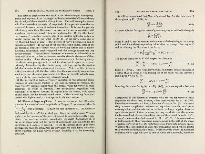

Here you go.
Randall does not have that much on nonlinear acoustics. You might want to look at the TOC before ordering. I posted the sample because it told the story at an intuitive level.
Nonlinear acoustics includes ideal gases for “large“ amplitude waves. Standard acoustics is for “small” amplitude waves. There are different nonlinear formulations depending on the specific application.

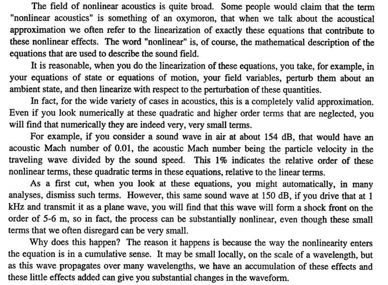

It’s complicated and many times it depends on what question you are focusing on. Here is an exerpt from the Hamilton transcript mentioned earlier.

For an ideal gas, the sound speed changes for overpressures greater than zero.
The proper question is when does it begin to change the answer. For Hamilton’s example, you see effects at ~630 Pa.

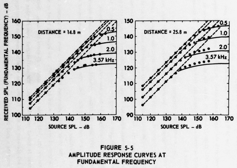

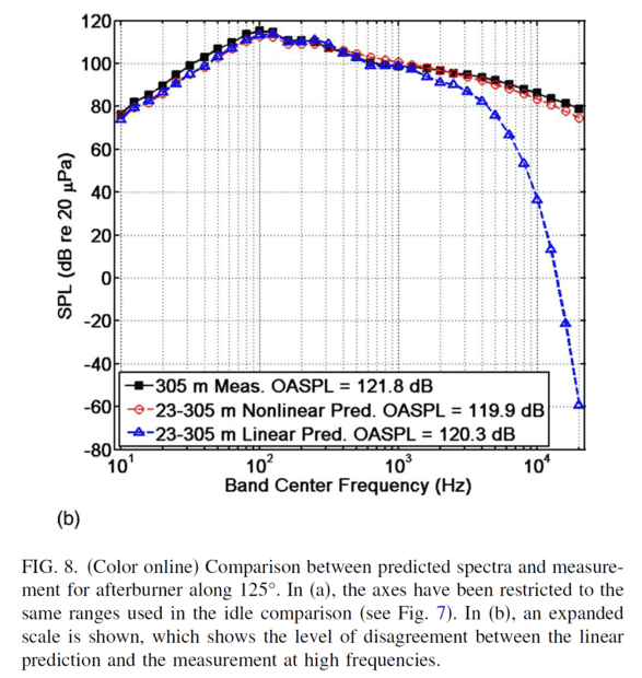

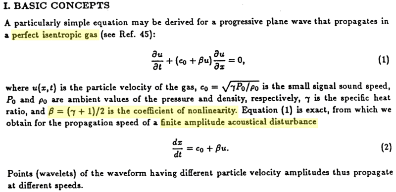

Hamilton's example pressure is roughly similar to that from an answer I gave to Squizzy three weeks ago in a private conversation. I quote below a portion of my message to him:
"What constitutes a "small amplitude" acoustic wave in air depends, not just on overpressure, but also on wave frequency and propagation distance. Take a look at the following graph for single-frequency, plane-parallel sound waves from https://apps.dtic.mil/sti/tr/pdf/ADA035694.pdf:
Evidently, nonlinear propagation of finite-amplitude sound becomes more pronounced for higher frequencies and longer distances. But note that among all the measured cases, linear (small-amplitude) behavior persists for source SPLs of less than about 135 dB. So one very particular answer to your question is:
In the frequency band 0.5−3.57 kHz over distances between 14.8−25.8 m, a maximum source SPL/overpressure of ∼135 dB=112 Pa=0.016 psi can be propagated by a small-amplitude sound wave. Beyond that the wave enters into the regime of finite-amplitude nonlinear acoustics."
But since Squizzy is still asking about this, I guess he rejected my answer. Maybe your Hamilton quote will be more convincing to him!

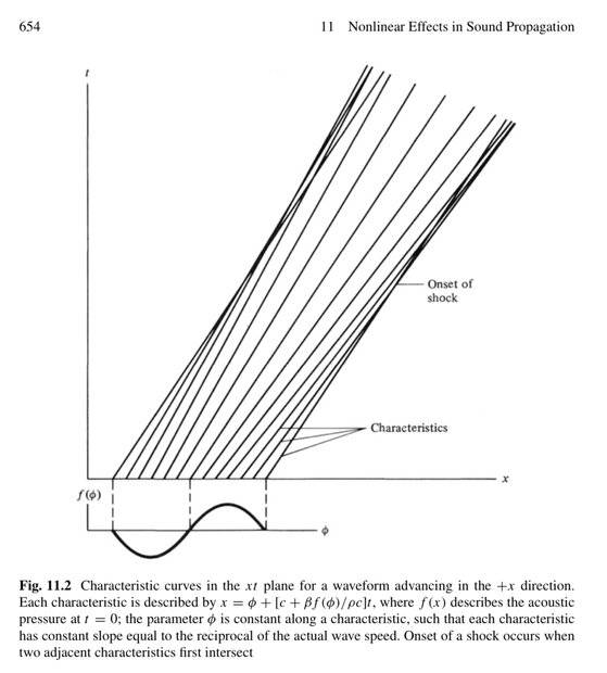

Not necessarily. Things have to take time to catch up. Here’s a plot from Pierce.
