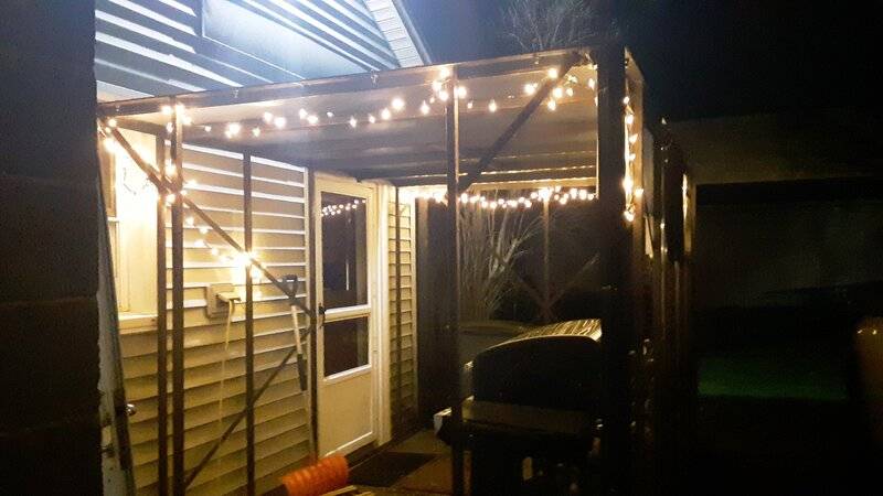

I have a steel cage 7 ft by 11 ft and 7 ft high. It's made out of standard 1 in square steel vertical tubing. Each vertical tube is spaced 18 inches apart all the way around the cage. All vertical posts are welded to a 2 in L-bar all the way around the top, and the bottom.
I'm trying to calculate the load this structure can carry if I install an A-frame style roof on it.
It's across the 11 ft width, with center roof support in the middle, by means of a 2x4 across the 7 ft span with vertical 2x4's 16 in apart carrying the roof. Similar 2x4's laying across both ends, where the roof ends.
All I find online is load calculations of horizontal square tubing, nothing on the vertical load. Any help is appreciated.

What keeps this structure from racking? You did not mention any diagonal members or shear wall structure.
What is this enclosure going to be used for? What kinds of things can happen if it fails?
Can you upload some pictures or mechanical drawings to help us see what you are asking about? Thanks (use the "Attach files" link below the Edit window)

Thanks for the reminder, yes it has flat crossbeams 1 in wide. a cross from each corner on all 4 sides.

Basically it was used to ship CNC machine from Taiwan to the US. The company I worked for was throwing it out... I was able to bring it home. It will double as a mudroom and greenhouse, hence all glass panels around 3 sides. Unfortunately no drawings are available, so I am trying to 'calculate' it... Thank you

Thanks for the picture; it's a big help. Several other replies so far mentioned snow loading, and from the pitch of your house's roof it looks like you do get snow where you live. What shape were you planning for this addition's roof? I would think that it would need to be a single inclined piece with the same pitch as your house's roof and angling up into the east side of your house, right? You would want the snow to be falling off the extension's roof toward the east, and not building up between the top of a peaked roof and the east side of the house.
BTW, can you anchor the structure and the peak of the angled roof to the east exterior side of your house? That would give you a lot better structural integrity and help to weather seal the roof peak against the side of your house.
double incline, downslopes facing south and north, indeed same angle as existing roof line.

TBH, the frame looks pretty flimsy to me, but I'm an EE not an ME. What will the sides be made of for this greenhouse? Just plastic sheets that offer no support or maybe Lexan sheets that can be part of a shear wall structure plus add compressive support? I guess at a minimum if you are using plastic sheets for the walls of this greenhouse, you could make the "roof" a thick plastic sheet that you pull from the structure's east wall up to just under your house's roof. That will give a nice tall angle for dropping off any snow load, and will not add weight to the structure that it has to support with those thin wall beams.
The wall height is 7 foot = 84 inches. The 1"x1" vertical columns are therefore 84 times longer than their width. That is greater than about 60, so there is a column stability problem. Buckling failure of the columns will be critical and must be analysed. Check the degree of freedom at the column end attachments. Design in some cross-connections between columns that will reduce the free length of columns to prevent buckling.
The walls must support the structure without the cladding in place. The walls must survive any probable side force applied. What might those forces be in this case ?
The steel structure is stronger than it looks. It will have used aluminum frame full glass panel patio doors screws to the inside of the structure.

roof is sheetmetal and will have A frame roof with 3/12 pitch on it both slopes on the 7 ft sides.
