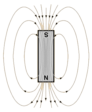

They are computing ## B=\mu_o H ##, where ## H ## is computed just like ## E ##, but for magnetic charges, ## \mu_o ## replaces ## \epsilon_o ##.
## R ## is the radial location on the endface of the cylinder over which ## dA=R \, dR \, d \Phi ## is integrated.
The endfaces have magnetic surface charge density ## \sigma_m=\pm M ##.
## \rho ## is the radial distance in cylindrical coordinates of the point of observation where the field is computed.
One additional item: I like to use ## B=\mu_o H+M ##. They use ## B=\mu_o H+\mu_o M ##, so that their ## \mu_o M ## is my ## M ##.
After computing ## H ## at some observation point outside the material, you then compute ## B=\mu_o H+M ##, but this ## M ## is zero, (outside the material), so ## B=\mu_o H ##.

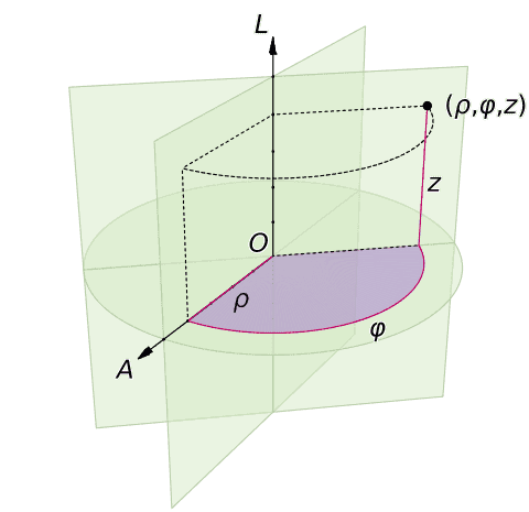

To answer the immediate questions above, ##z## and ##\rho## are coordinates in a cylindrical system. You should review cylindrical coordinate systems to get the right orientation to the symbols.
https://en.wikipedia.org/wiki/Cylindrical_coordinate_system

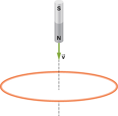

My aim is to find the induced emf as a cylindrical N42 magnet falls through a coil of N loops.
To calculate this I use Faradays Law.
Now for that, I need to find the magnetic flux in the first place using the equation:
$$\phi =\oint BdAcos\theta$$
This is why I am now trying to find B for the magnet, in order to work out this problem.
I am attaching a picture below that might perhaps help with visualisation.
So yes, indeed involves a moving magnet.

They are summing (integrating) all the contributions to ## B ## (or ## H ##) at a point ## (\rho,z) ## where with cylindrical symmetry, it is independent of ## \phi ##). The radial distance ## \rho ## is measured perpendicular to the z axis. The magnet has center at the origin, with endfaces at ## z=\pm L/2 ##.
The magnet has radius ## a ##, and ## R ## is the radial variable on the endface.
The ##B_z=\mu_o H_z ## is readily computed using the pole model=they used a different approach using the gradient of the magnetic potential, but here I do prefer just computing ## H ## how the electric field ## E ## is computed. You should be able to follow how they did the integral over ## R \, dR \, d \Phi ## in polar coordinates. To get the z-component, there is a simple factor tacked onto the inverse square.

Ok, thanks. This makes the problem not simpler but at least straightforward.
Is that just some photo you found or is it your own setup? I ask because if it is your setup perhaps you already have data to compare to your calculation when that is done.
My recommendation is to forget the loop and any motion for the moment and just calculate the magnetic field from this combined magnet in 3D space for all space in cylindrical coordinates. First pick a convenient location for the origin. There should be enough to informatin above to do that.
After that you will introduce the loops into the picture and calculate the flux at any point along the axis.
Then, since the induced ##emf = - \frac{d\phi}{dt}##, you can move the loop along the axis. The motion of the loop if it is falling is controlled of course by gravity or you can study it for different assumptions, like a fixed velocity for comparison.

Yes, this is a picture of my own setup, and yes I am aiming to test results using this setup and have already collected data.
Now as you know I am just trying to find the magnetic field. The origin of what exactly are you taking about? I assume you understand the posts above better than me, so perhaps you could give me a more simple explanation on what the components ## \rho ## , ## z ## and ## R ## represent? I have been trying to figure this out using the posts from @Charles Link , which are really great but somewhat complex to understand for me...

The components ## \rho ## , ## z ## and ##\theta## are the variables of the cylindrical or polar coordinate system. I believe ##R## was used above just to represent integration over the radius of the magnet.
The problem will be ill defined until you establish a fixed coordinate system to work in. That means placing the magnet in that coordinate system say, with the exact center of the magnet at the origin.
