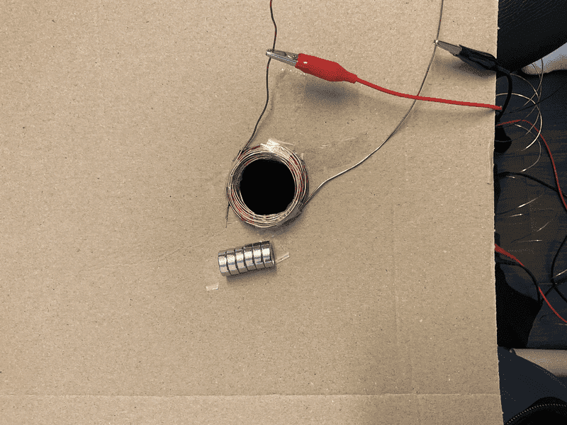

It's a bar magnet falling through a loop.

See the image in post #40. It looks like six N42 magnets and the loop is 2 or three times as big.

So, we have the magnet of know dimensions falling from a certain height above the loop and at rest. I see a couple of issues.
First, the ##B_{\rho}(z.\rho)## component of the field at the loop will cause a force and thus a force will be on the magnet too trying to resist it's motion. If the field is weak at the edge of the loop it can be ignored.
Then, if there is no analytic expression for ##B_z(z, \rho)##, there will not be an exact analytical expression of the flux change.
Since one would need ## \large \frac{dB_z(z,\rho)}{dt}## which would be ## \large \frac{dB_z(z,\rho)}{dz} \frac{dz}{dt}## which is ## \large \frac{dB_z(z,\rho)}{dz} v(t)##
but there is no analytic expression so I think you have to evaluate the flux at set times
and compute the flux change as ##\large \frac{ΔΦ}{Δt}##.
