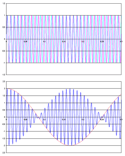

Beat pattern is superposition of two sine functions with a little frequency difference. (http://en.wikipedia.org/wiki/Beat_(acoustics)#Mathematics_and_physics_of_beat_tones)
We use this pattern to generate a surface, by adding another beat pattern with 60 degrees difference.
Now, normal beat pattern has a well known super-period. But I need a similar formula for determining super-period of any cross-section from the origin. I need such a formula to use it in simulations.

What I mean by super period is the period of the envelope function. If you examine the beat curve
the envelope function has a period of P1*P2/(P1-P2), P1 and P2 are periods of two sine waves that are superposed to produce this beat pattern.
I need a similar formula or a way to calculate the super-period of each cross-section.
Addition of two sines can be rewritten as multiplication of one cosine and one sine functions, then the cosine function forms the envelope. However, I couldn't come up with a similar formula for addition of four sine functions, which produces the resulting cross-section.
