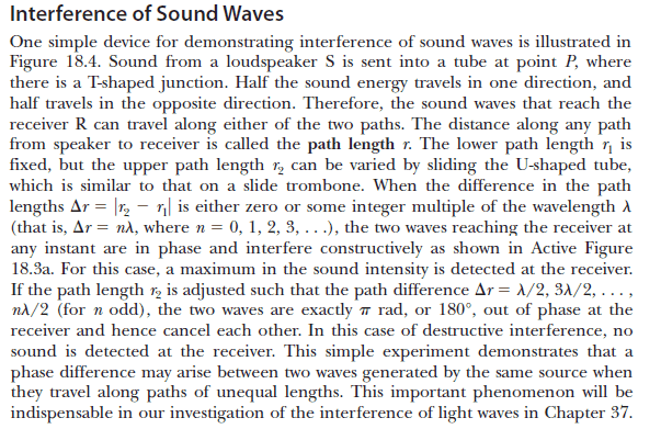

An observer stands 3 m from speaker A and 5 m from speaker B. Both speakers, oscillating in phase, produce waves with a frequency of 250 Hz. The speed of sound in air is 340 m/s. What is the phase difference between the waves from A and B at the observer's location?
$$Δr=|{ r }_{ 2 }-{ r }_{ 1 }|\\ =2$$
I have no idea what to do. What the textbook says is attached. This was a test question. :(

OK so the difference in distance is 2m as you state.
What is the wavelength of the sound?
And what relates wavelength to phase angle?
I've calculated the wavelength to be 1.36m. But I have no equation that relates wavelength to phase angle.
If I separate two waves of the same wavelength by one wavelength the phase difference is defined to be 2pi. Take it from there.
2m/1.36m*2pi = 9.24 rad = 2.96 rad
Is this right?
I didn't realize Δr had anything to do with wavelength.
Is this right?
Exactly right. The phase difference is actually 9.24 but you would measure 2.96.

No. It's like a clock that went round from noon to noon. Difference = 0 but it's a day later!
But OK - if you're asked to find the phase difference between two monochromatic (one and only one frequency) signals, always give an answer either between 0 and 2 pi or between -pi and +pi, just like you did. You can't measure any differently (unless we're dealing with signals of finite-width spectra, e.g. a signal with a mixture of between 500 and 501 nm. Then than interferogram (beating the two signals aginst each other) would look like a standard monochromatic interferogram except the peaks would diminish with the fringe number. And each fringe = 2 pi. If this sounds like gobbledygook, don't worry about it.)
