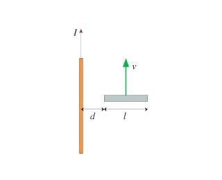

The metal rod in the figure moves with speed v parallel to a straight wire that is carrying current I. The distance between the two wires is d, as shown in the figure.
If the end of the rod closest to the wire is chosen to be at zero potential, what is the potential at the end of the rod furthest from the wire?
Give your answer in terms of I, v, d, l, and constants u0 and pi.

consider some charge on the metal rod, now metals have electrons as conduction charges, but since conventional direction of the current is that of positive charges, consider positive charge, q. the direction of [itex]\vec{v}\times \vec{B}[/itex] at any point on the rod is into the paper. now according to lorentz force law,
[tex]\vec{F}=q(\vec{v}\times \vec{B})[/tex]
while talking about the potential difference we talk about unit charges, so let q = 1 C.
now
[tex]V_B-V_A=-\int_A^B \vec{E}\bullet\vec{dl}[/tex]
since q is 1C, the above equation can be written as
[tex]V_B-V_A=-\int_A^B \vec{F}\bullet\vec{dl}[/tex]
can you work this now , going from nearest point to farthest

I would go it another way:
If an element of wire dL moves in a B field orthogonal to dL and with velocity v orthogonal to both B and dL, what is the induced emf?

Hi!
VB−VA=−∫F⃗∙dl⃗
For a wire, B= μ0I/2(pi)r
VB-VA=−∫F⃗∙dl⃗ = -∫μ0I/2(pi)rv.dl, integrating from d to (l+d)
This gives me an answer: μ0I/2(pi)v log((l+d)/d)
Am I heading in the right direction?
starshine, yes , i think negative sign is missing... V(d)=0 as given in the problem
so V(l+d)-V(d) = -(what you got) ... -------> delta V =-(what you got)
