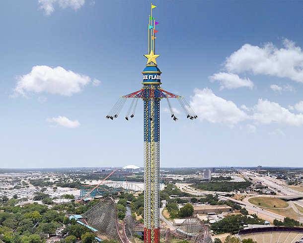

Was not sure where to post this specifically, but I am looking to calculate the possible distance traveled by by a projectile from a set height, speed, and release. Its just curiosity from seeing a new ride being brought to my local theme park.
Height of release is 121.92 meters.
Mass of projectile is 90.72 kg.
Radius is 6.01 meters.
Velocity is 15.65 m/s.
Centripetal force is 3697.07 N.
Angle of release is 45°.
Thanks for any input on this.

got the centripetal force from f= mv2[itex]/[/itex]r
forgot to mention its a swing style ride
I am assuming a perfect release angle of 45 degrees... just to try and simplify...

mfb, you were assuming initial and final height were to be the same, which they are not. so you do need the initial height as well
[edit: also, i am a bit surprised you would calculate the time to go up and the time to go back down separately... but i guess it is a good exercise for the reader to see if they notice the symmetry :p then you completely do not need to calculate the height of the peak as well]
shini, centripetal force is irrelevant - it does not act after you have released the projectile.
angle of release may also not be 45 degrees. seems it actually is 0 degrees, i.e. moving entirely horizontally at release. it is not optimal for maximum distance, but i don't imagine you being able to impart any reasonable vertical component to the projectile velocity, so that is that. this actually simplifies the calculations a good bit.
Looking at this ride, I see that an experimentalist could make the front page of both reddit and youtube by determining the result in the manner [STRIKE]prefered by[/STRIKE] unique to their profession.
I agree.
While 0° is not optimal*, it is quite close to that.
*looking at the context, I would think that "optimal" is more like "worst case" here.
