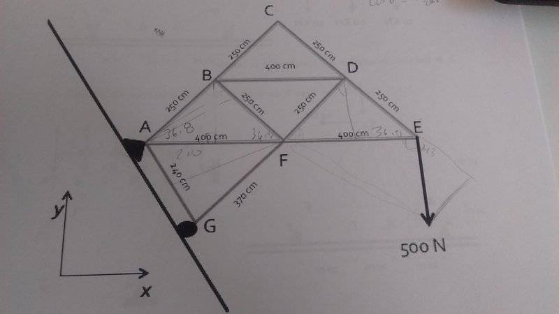

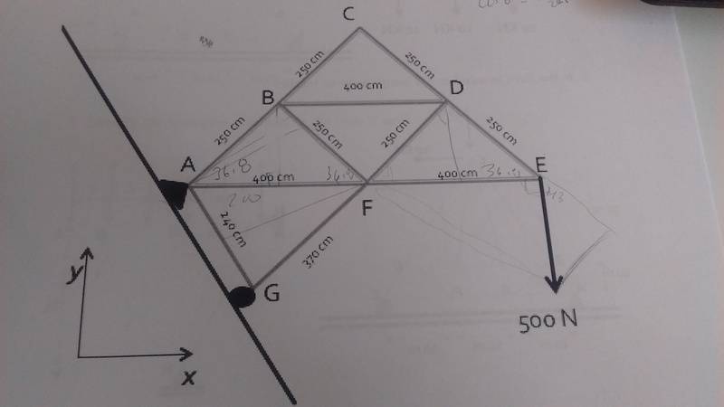

http://[ATTACH=full]199940[/ATTACH] I am having trouble with this truss problem. I have attached my work so far. I used the entire structure as a system first and did the sum of the forces equals zero but I don't know how I can finish the moment at a because I don't know the x and y distances for the 500N force. and I have no idea where to go from there and have been working on it for a long time. I get so lost with the angles in problems like these. help would be appreciated. thanks!

You have to pick a triangle and work out the angles.
The triangles ABF, BFD, BDC, and FED are all the same: isosceles triangles with a base length of 400 cm and identical sides of 250 cm.
Triangle AGF is an oddball, but it still can be solved. Remember the Law of Cosines?

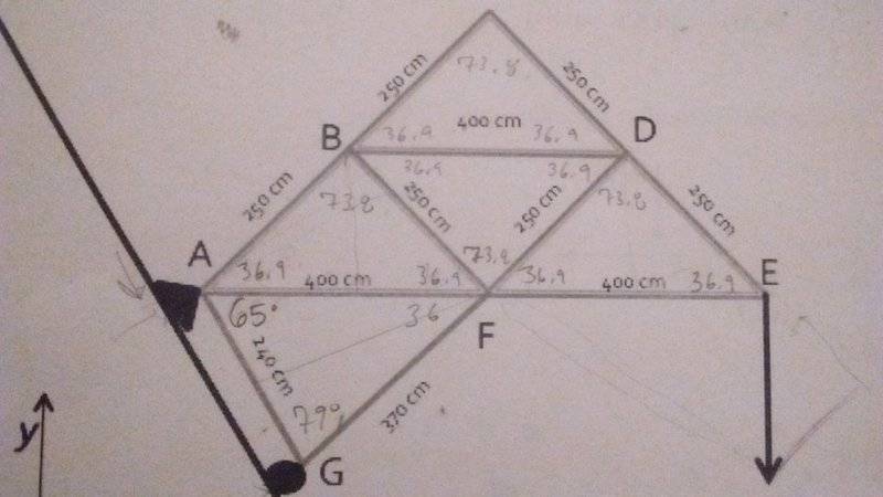

thanks, but I am still stuck. So I have figured out all the angles(picture attached) but I still can't figure it out. if i make my coordinates line up with Ax and Ay what degrees I would use for the x and y component of the 500N force. (when I am taking the moments about A and the sum of the x and y forces of the big triangle as the system. or is this not necessary and can i start at some other triangle to get the answer?

It looks to me like the 500 N force is a gravity load, like something suspended from this truss. The 500 N has only a vertical component.

even if i change the axis? then it wouldn't be only in the y direction.. but if i keep the axis as shown in the picture i don't know the angle to use for Ay because it cuts the triangle in a way where i don't know the side lengths and therefore can't find the angle
