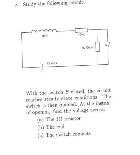

H= (NI)/ (2(Pi)r)
V=IR
a)
total resitance = 100ohms?
from this would the current be 0.12A
over 1ohm resistor: 0.12V
not sure if this is correct even. Any help would be much appreciated.

If I have calculated correctly, the total impedance is 104.40 ohms, [tex]\phi = 15.63^{o}[/tex] when the switch is open. Then you can use [tex]V = V_{source}\frac{Z_{R}}{Z_{total}}[/tex]
I'm not 100% that this is the way to do it though.
