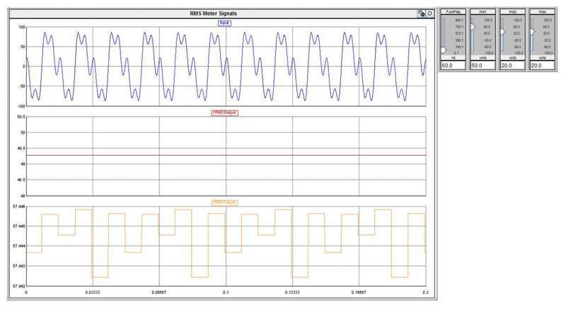

Every 50μs I have access to one sample of an unknown peroidic input signal and I am looking to calculate the RMS of the fundamental component. Is there any convenient ways one can think of doing this?

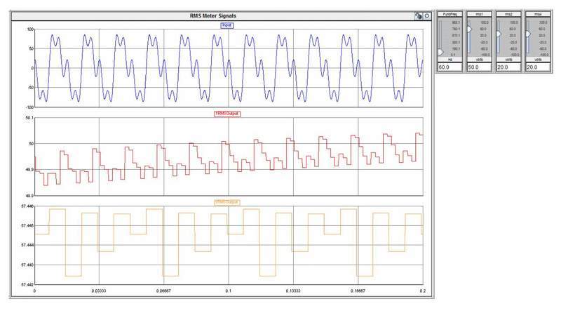

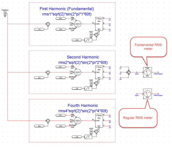

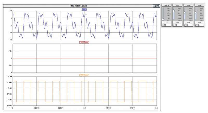

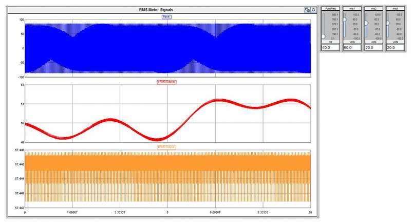

Assume we have an unknown peroidic input signal that we can obtain samples of every 50μs timestep. (We have the ability to access the input every 50μs timestep, that doesn't mean we HAVE too)
Assume that we know beforehand that the fundamental of this input signal equivalent to,
[tex]M_{1}sin(1t)[/tex]
Then we expect the output (i.e. the RMS of the fundamental component) to be,
[tex]\frac{M_{1}}{\sqrt{2}}[/tex]
Now if the input signal were to suddenly change such that the fundamental of this altered input signal is equivalent to,
[tex]M_{2}sin(1t)[/tex]
[tex]\frac{M_{2}}{\sqrt{2}}[/tex]
and so on for any arbitrary periodic input.
I would like to have my output transition from say,
[tex]\frac{M_{1}}{2}[/tex]
to,
[tex]\frac{M_{2}}{2}[/tex]
as quickly as possible.
Is it more clear what I am trying to achieve?

The signal is likely to be a voltage or current from within a power system. At this point I am unsure what level of noise will be present, but perhaps knowing that the signal is coming from a power system context, you can infer what level of noise will be present, but I'm not sure.
I want the RMS of the fundamental because this is a common index that people use in a variety of different applications. (i.e. for protective relays applications etc.)

Here is the test case I've developed for the testing of fundamental RMS component. As you can see I generate three sinusoidal harmonics and add them together to create my input signal.
Test Case Picture
[tex]Input = rms1\sqrt{2}sin(2\pi(1)60t)+ rms2\sqrt{2}sin(2\pi(2)60t) + rms4\sqrt{2}sin(2\pi(4)60t)[/tex]
In this particular test case we have,
[tex]rms1 = 50.0, \quad rms2 = 20.0, \quad rm4 = 20.0[/tex]
Here are the simulation results,
Legend:
Input - Input Signal
fRMSOutput - Fundamental RMS component output
tRMSOutput - Regular RMS component output (computes the total RMS)
With a short simulation time (0.2s) we observe the following waveforms,
Short Simulation Time Results
If we look at the results over a longer simulation time we can see the results are oscillating over time,
Long Simulation Time Results
However, if I select the frequency of the fundamental such that it is an integer multiple of the timestep these deviations go away. If,
[tex]f = 50Hz, \quad dt = 50\mu s \Rightarrow \frac{50}{50\times10^{-6}} = 1 \times 10^{6}[/tex]
we observe the following results,
Integer Multiple of Timestep Results
From these results I'm thinking the smaller deviations visible in the short simulation time results are because the samples aren't being taken at the same points each cycle. This is happening because the peroid of the waveform does not fit into an integer multiple of timesteps.
Another weird result I found is that with the fundamental frequency set to 60Hz (i.e. not an integer multiple of the timestep) if I increase the number of samples per cycle from 8 to 32 the deviations disappear completely, but the results still aren't entirely accurate.
32 Samples Per Cycle Results
Please let me know of your thoughts/comments/suggestions. Any idea why I am seeing some of these discrepancies in my results?
