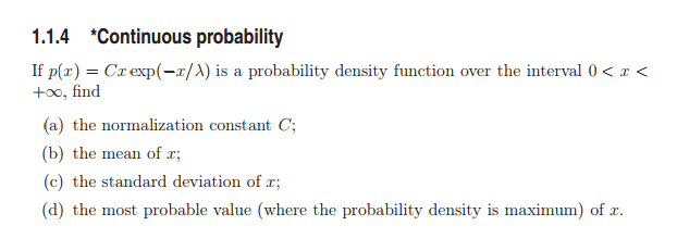

Schwarzschild90
111
See below
\begin{align}
\begin{split}
p(x) = C \ x \ exp(-x/ \lambda)
\end{split}
\end{align}
If $p(x)$ is a probability density function on the interval $ 0 \textless x \textless + \infty $ , then it follows that the normalization constant can be isolated by setting the area under the curve equal to one
\begin{align}
\begin{split}
\int_0^\infty p(x) \ dx = 1 \to \\ C \int_0^\infty x \ exp(-x/ \lambda) \ dx = 1 \to \\ C \lambda^2 = 1 \to \\ C = \frac{1}{\lambda^2}
\end{split}
\end{align}
\subsection*{(b)}
The mean $\mu$ (or expection $E(X)$) of X is
\begin{align}
\begin{split}
mean = E(X) = \int_a^b x \ f(x) \ dx = \frac{1}{\lambda^2} \int_0^\infty x^2 \ exp(-x/ \lambda) \ dx = 2 \lambda^3
\end{split}
\end{align}
\subsection*{(c)}
Now, determine the standard deviation $\sigma$ of X
\begin{align}
\begin{split}
\sigma =
\end{split}
\end{align}
In 3), did you forget the factor C?
Are you stuck on the standard deviation, or did your post just get truncated?
What formulae do you know related to variance and s.d.?

I imagined that someone could see if what I had already done was correct
I know the following formula for variance: (E(X^2) - mu^2)

Your computation of ##EX## is incorrect.
Hint: check dimensions. If ##X## happened to be a time, ##\lambda## would have dimensions of time also, and so your ##\lambda^3## would have dimensions of ##\text{time}^3## (but should be just 'time').

I forgot to divide by λ2.
Now, does 2/λ seem reasonable in your eyes?

Now you seem to have divided by λ4.
If you replace x with λu in the integral you can see you should get a factor λ and an integral independent of λ.

So turn that into an integral. You already have μ.

Like this? I don't understand why we replace x with lambda u

I was just using that to show that the final expression must be linear in lambda.
##\frac{1}{\lambda^2} \int_0^\infty (\lambda u)^2 \ exp(-(\lambda u)/ \lambda) \ d(\lambda u)=\lambda\int_0^\infty u^2e^{-u}.du##. Your first version ended up with a factor λ3 because you forgot the factor C=λ-2, but then somehow you got λ-1, as though you made the correction twice over.

So, 2\lambda would be correct?
Yes.

Will use this formula to calculate the standard deviation

Ok, but you might find the form var(X)=E(X2)-E(X)2 more convenient than E((X-E(X))2).
I assume sqrt(E(X2)-E(X)2)?

For standard deviation, yes. I was quoting formulae for variance (σ2).

\begin{align}
\begin{split}
E(X^2) = \frac{1}{\lambda^2} \int_0^\infty x^3 \ exp(-x/ \lambda) \ dx = 6 \lambda^2 \\
\mu^2 = 4\lambda^2 \\
\sigma = std(X) = \sqrt{var(X)} = \sqrt{E(X^2) - \mu^2} = \sqrt{6\lambda^2 - 4\lambda^2}= \sqrt{2\lambda^2} = \sqrt{2}\lambda \\
\end{split}
\end{align}
It seems almost impossible to commit a mistake using the above equation :P, but I've been wrong before

Looks right.
