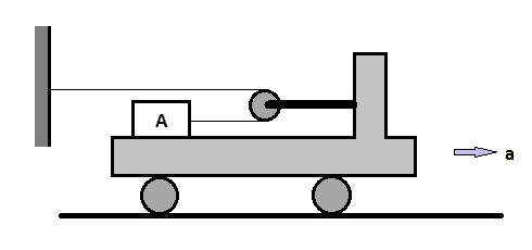

1. If flat car is given an acceleration a = 3 m/s^2 starting from rest, compute tension (in N) in the light inextensible string connected to block A of mass 30 kg. Coefficient of friction between block and flat car is = 0.50.
Neglect mass of pulley and its friction. Take g = 10.
2. Friction = ## \mu N ##
F = ma
ma = mg - T
3. No idea. I couldn't approach the problem. Please tell me how to approach these types.

Write the Newton's laws in the frame of the ground. It is an inertial frame. Write down all the forces(along both axes). Also observe that for every meter the car moves, block A moves by 2 meter.

In case pcm's post is not clear enough, it's the forces on the block that matter. You don't need to analyse forces on the cart since its motion is a given.

What are the horizontal forces acting on the block? What is the acceleration of the block? What equation does that give you?
Friction and tension.
Same as acceleration of the car(truck)?
Net force on the block=mass of the block multiplied by acceleration of the truck.
if the acceleration of the block = 2 * truck acceleration, then the force required in the string = m * a
then add the friction force
why should I add?
acceleration force is forward (say + ve) and friction force is rearward (say - ve), the tension force is the difference.

gracy, do you see why the acceleration of the block is not the same as the acceleration of the truck?

That's a different situation. In the textbook example, the only force accelerating the block is the friction, so of course it must be acting in the forward direction. In this thread, there is a string pulling on the block.
Friction always opposes relative motion of the two surfaces in contact. Which way does the block move relative to the truck?

Yes, sorry, I meant in this thread, which way does it move relative to the "flat car".
gracy said:
Why?
What is the acceleration of the block relative to the car?
Does the total length of the string change?

Tension in string is pulling the block in forward direction, right?
Right.
So,to find in which direction the block will move,I need to know force is larger in which direction,i.e tension +force by truck in forward direction should be greater than force of friction then only block will move in forward direction.
You know which way the block will move relative to the car (since the string neither stretches nor breaks).
And what do you mean by "force by truck in forward direction"? There are only two horizontal forces on the block.
I only know force of friction (static in nature) i.e 0.5 multiplied by 30 multiplied by 10=150 N.
