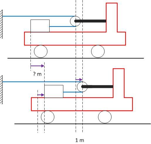

The string is of constant length. If the car moves 1m, the top part of the string gets how much longer? What does that tell you about the length of the lower part? How far has the block moved?

I think the top part of the string should be
  • #52
gracy said:
I think the top part of the string should beView attachment 81886
That cannot be string, or the pulley would fall down. Must be a rod.
The upper part of the string runs drom the wall to the pulley. How much longer does that get when the car advances 1m?
  • #53
Same as distance covered by small block.
  • #54
No. Forget the block for the moment, and concentrate on the car, the pulley, the wall, and the length of string from wall to pulley. If the car moves 1m further from the pulley, how much longer is that part of the string?
  • #55
Total length of string - length of the top part of the string ?
  • #56
No, I'm asking about that top part of the string, the part that runs horizontally from the wall to the pulley.

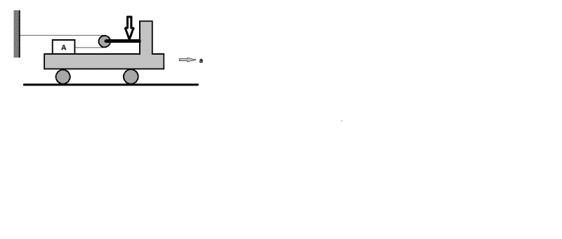

  • #57
gracy said:
Total length of string -(minus) length of the top part of the string .Right?/QUOTE]

  • #59
If the car moves 1m further from the wall, how much further is the pulley from the wall? So how much longer is the piece of string from the wall to the pulley?
  • #60
1 meter?
