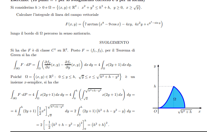

look at the image
stocks theorem
Greetings
The exercice consist of calulating the circuitation of the Field F along a the borders of the region omega
my problem was how they found that y goes from 0 to h ( for 0 it´s clear but the mystery for me is h)
Thank you!
Compute the intersection between the curves ##x^2 + y^2 = h + h^2## and ##x = \sqrt y##.
Also, it is ”Stokes’ theorem” (or in the two-dimensional case, Green’s formula in the plane).

yes indeed we get
y^2+y-(h^2+h)=0
we use descriminant Δ=1-4(h^2+h)
y=[1+(-)sqrt(4(h^2+h))]/2 which is ugly
is there any simplification ?
thank you!

If ##y^2 + y = h^2 + h##, then it should be fairly obvious that ##y=h## is a solution.

thank you, I really didn´t see it!
To add to Oro's great hint:
Maybe factor :
## y^2-h^2=-(y-h)##?

amazing! thank you!
