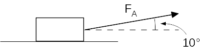

A force, FA, of 8.70 kN is the maximum force that can be applied to a 2.48 kN box before it starts to move. If the force, FA, is angled at 10.0° above the horizontal
was not given the equation to do this kind of problem or so i believe the one i was given is Fc+fn=Fg
i tryed putting all the number into that equation but it does not work, i have no clue if i need to include the angle to solve this or not and if i do i have no clue how i would

You likely have seen an expression for static friction which is something like ##F_\text{Static} \le \mu _\text{Static} \cdot F_\text{Normal} ## .
You were given the maximum force that can be applied before movement occurs, so equality holds.
It appears that you did not give a complete statement of the problem. (I assume that the box is on a horizontal surface.)
How is the force of friction related to the applied force, FA ? (The 10° angle is important here.)
How is the normal force to be determined?

Consider all the forces acting that have a vertical component. Write the force balance equation for the vertical direction. Then do the same for the horizontal direction.

thats where I am confused because of the angle in the x direction there is fn and fg and fa but at a 10 degree angle and in the y direction there is fs and fa at a angle so where does the 10 degrees go do i need to split the fa into its x and y components
Yes.

What are the horizontal and vertical components of the applied force?

What are the horizontal and vertical components of the applied force FA?

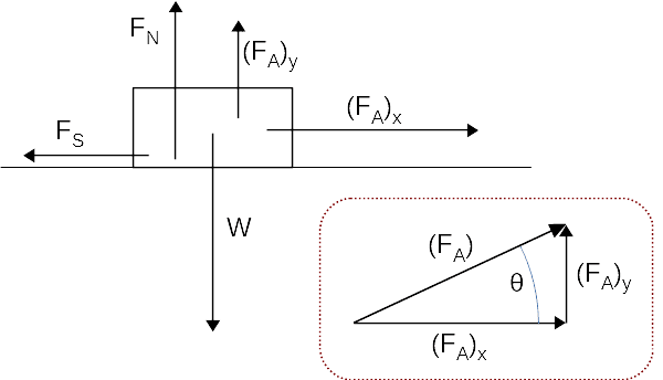

One thing which would be very helpful here would be a good sketch of the problem.
Better yet would be to use an F.B.D. (free body diagram).
What are the components of the applied force, FA ?

I see that @haruspex replied to this previously, but I will add my 2 cents worth.
As I stated previously, a Free Body Diagram, commonly abbreviated as "fbd",will help you solve the problem addressed in this thread. In general, FBDs are extremely useful and often necessary to solve statics and dynamics problems in physics and engineering. Here is a link to the Wikipedia page on FBDs.
Here is an FBD for your problem.
The vectors are not drawn to scale and the angle, θ, is not 10° .
FS is the force of static friction.
FN is the Normal force (exerted on the box by the supporting horizontal surface).
W is the weight of the box, what you referred to as fg in post # 16.
FA is the applied force. The inset in the above figure shows FA broken down into its horizontal (x) and vertical (y) components.
Some general comments:
Judging by some of your posts in this thread, you seem to be hunting around for some equation or formula which will allow you to plug in some numbers and get an answer which will satisfy your instructor and/or match some answer key. This approach is not likely to lead to much of an understanding of physics.
Use definitions, physical principles and fundamental laws to analyse the situation. Work from there to relate quantities you are given to the quantities asked for.
