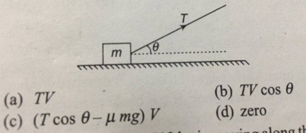

A block of mass m slides along the track with kinetic friction μ. A man pulls the block through a rope which makes an angle theta with the horizontal. The block moves with a constant speed v. Power delivered by the man is?
P= force in the direction of velocity x velocity
Frictional force = coefficient of friction x normal reaction
Force along the horizontal would be
T cos(theta)
Frictional force (which is in the opposite direction )= μmg
So net force in the direction of velocity = Tcos(theta)-μmg
P= [Tcos(theta)-μmg]v
But this is not so, the right answer is given to be Tvcos(theta). Why should we not consider the frictional force acting here ?
In this case the magnitude of the frictional force is not ##\mu mg##. What is it? Is the power delivered by the man related to the net force?

That it is. What is the normal reaction? Look at your drawing and write an equation for the balance of forces in the vertical direction.

Set friction aside and focus on the basics. You are looking for the power delivered by the man. What is the definition of power (I am not looking for Fv) delivered by a force? Note that the force exerted by the man is the tension T.

Ohh.. so power purely depends on the man ie the force he provides and the resulting velocity but not on any of the other forces that might act here. Am I right ?
Just wondering tho, will work done by the man be dependent on the friction? Will we have to add the frictional force in that case?
You are right.

Not quite. For a constant force,$$P=\frac{dW}{dt}=\frac{d}{dt}(\vec F\cdot \vec s)=\vec F\cdot\frac{d\vec s}{dt}=\vec F \cdot \vec v$$The vectors and the dot product make a difference which is one of the important points in this problem.
Ok so that’s why the force in the power equation is dependent on the man alone right ? Since it was derived from the work..
Right. Each of the forces acting on the block is associated with its own power. The man delivers power while the friction dissipates all of it because the net force does no work since it is zero.
