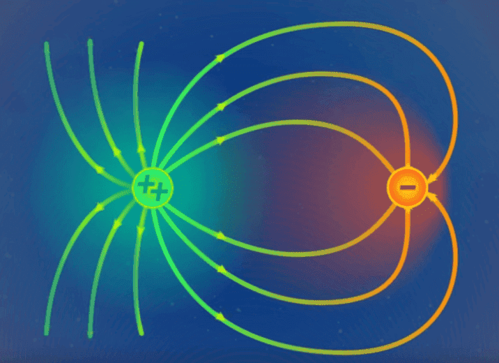

c) I attached a picture of how the equipotential lines will look for two charges. In our case it will be reversed, since Q1 = q and Q2= -2q.
I guess what I don't understand is how the equipotential lines relates to the electric field strength.

Your picture isn't really relevant when the exercise asks for fields at great distance. What counts is the net charge, and the first order in r-1 so for a) and c) you get the same answer.
b) is trickier: there net charge is zero and in the most sensitive direction (along the line connecting the charges -- think why that is so) the leading term is in r-3
Equipotential lines are like height lines on a detailed map: when they are close together, you know it's steep there.

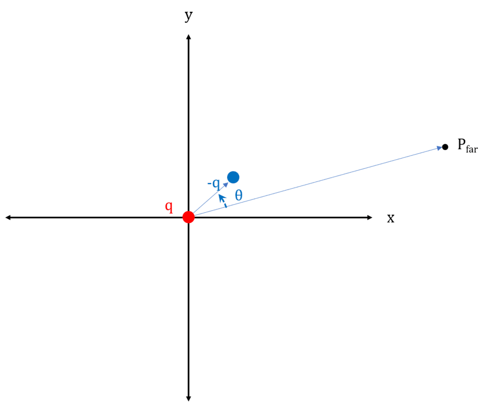

How do we normally solve this for other textbook problems? You break it up into vector components and sum up the components. I'm aiming for the lazy approach here (maybe it's wrong so feel free to correct me I don't mind) and there's something very convenient about this problem. What I can do is call ##\theta## the angle between ##\vec R_1 - \vec R_2## and ##\vec R_1##; I could also say that ##\hat R_1## is the same direction as ##\hat R##. You've solved for this problem in part (a) so you're already done with half of it if you think about it this way.
How to break ##\vec R_2## into ##\hat R## components and ##\hat \theta##? Good news is ##\hat R_1## has no ##\hat \theta## components with this approach. I would take the projection of ##\vec R_1 - \vec R_2## onto ##\vec R_1##, then you know that the ##\hat R## component is ##R - dcos\theta##. The ##\hat \theta## component isn't too bad of a geometry problem ;).
Diagram of a dipole in the xy-plane: a red charge q at the origin and a blue charge -q at an angle θ from the x-axis, with a line from the origin to a far point P_far on the right.
When you do the mathematics you'll come across a seemingly shocking result if you assume that ##R \gg d## and you happen to know the answer from a textbook solution of a dipole where the two charges on the ##z## axis. If you rotate the textbook solution a bit... it'll give you confidence in the approach, and the results look reasonable too when you reuse the approach for ##Q_2 = -2q##.
