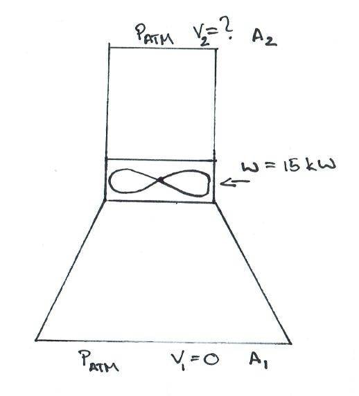

Hi,
This is my first post on the PhysicsFormus
I am trying to design an inlet and outlet for an axial fan and calculate velocity and pressure profiles in the duct. See the sketch attached. The ultimate goal is to carry out a CFD study but I was wondering if there is an analytical solution for a simplified case, so I can have some estimation. I did some research and was trying to apply "actuator disk theory" (linked), but I do not find the results believable (see spreadsheet attached, I simplified the problem to have a uniform section area).
Let me know if you have any suggestions on how to tackle this problem!
EDIT: Calculations and sketch attached, apologies for "Google-Driving" them first

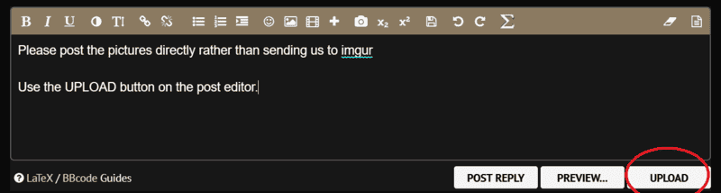

Please don't send us to Google drive to open files. Use the UPLOAD button to insert pictures into your post.

Hi Anorlunda,
Apologies, somehow I missed this functionality... all attached "properly" now :)

Yeah, I guess I saw this two weeks ago and wasn't clear on what the goal is. I didn't do a detailed check of your math, but it looks like you are using the area/velocity relationship and kinetic energy to find power. That's fine except for two problems I see:
1. If V1 is zero, how can V2 be anything but zero?
2. You don't have an efficiency factor for the fan...and it won't be constant.
What are you trying to use this for? It is tough to know if you are on the right track not knowing what problem you are trying to solve.
Thanks for your reply Russ,
I am trying to use this for calculating force acting on the walls of the inlet duct, resulting from low pressure in the fan inlet and ambient.
With the issues you pointed out:
1. I am happy to use V1=/0
2. I am happy to neglect efficiency at the beginning. I will be making a scaled model of this system, so will get some idea about efficiency vs speed from there.
Let me know what you think

I am trying to think about an analytical way to model this problem and find a solution that's at least an order of magnitude accurate.
The problem as I described above is actually pretty simple. I suggest picking some performance parameters and solving it with Bernoulli's equation. There are some little intricacies, but we can walk through them.

It does sound simple, I am not sure though how to use the pressure value from the fan performance curve. I thought it's the pressure "built up" by the fan downstream? Which means I cannot use it for Bernoulli equation between the slot and the fan face?
If I do I get a calculation as the one attached (with a drawing, fan here), but I do not "like it" - it assumes only the slot is in the low pressure zone?
