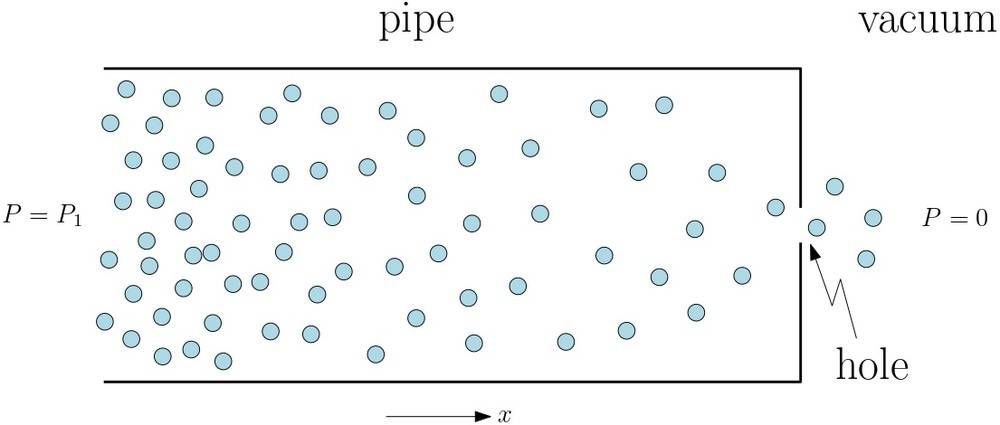

I'm trying to calculate the dependence of pressure on distance, i.e. P(x) in a gas flow problem: I assume a tube (pipe) filled with some gas (say argon), with pressure P1. At some moment, a small hole (orifice) in the pipe is opened and a gas starts to flow outside, into a vacuum (P2=0). As a result, the pressure decreases towards the hole. I want to calculate this reduction as a function of distance from the hole.
The setup is something like this:
And I want the solution P(x), like the green graph here.
From a "quick" search (that already lasts 3 days) I first found a barometric formula, but realized I have no external forces in my case to use it. Next, I found the formula that relates the pressures with the Mach number M and ratio of specific heats gamma:
but, the Mach number is the ratio of the gas speed to the local speed of sound, and gas speeds w(x) are unknown. So, I 'm sort of came back from what I started from.
I also found a formula that relates the gas speed (w2) at the orifice to the pressures and initial gas speed (w1), volume(v1):
but, this gives me only one point on x axis, and this point I actually already know (it's P2, or very close to it).
I'm already after reading a couple of dozens websites on the subject, some books (Caro, Bansal, Sutton).
I appreciate any help, advice and / or suggestions where to dig in next. Thanks!
Your setup has two flow-related pressure drops in series. There is a friction loss in the pipe that is a function of the flow rate, and there is a flow rate through the orifice that is a function of the pressure immediately upstream from the orifice. Your sketch (nice sketch, BTW) shows that you recognize the pipe pressure drop.
To find the pressure drop in the pipe, search Moody Diagram. That diagram, with it's equation, works for any gas.
The flow through an orifice is either subsonic or sonic, depending on the pressure ratio. In your case, the downstream pressure is zero, so the pressure ratio is infinite. Your orifice flow is choked. Search choked flow through orifice to find how to calculate it. The flow rate in choked flow is dependent on the upstream gas density.
Calculate the pipe pressure drop for a range of downstream pressures. Plot on a graph. Calculate the orifice flow for the same range of downstream pressures. Plot on the same graph. The downstream pressure is the pressure immediately upstream of the orifice. The intersection of those two flow vs pressure graphs is the flow rate.
Now that you have the flow rate, you can go back to the Moody chart, and calculate the pressure at any point down the length of the pipe.

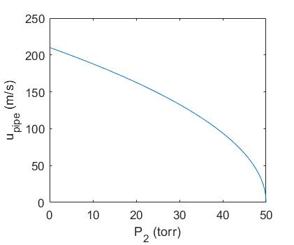

Calculation of the flow through the pipe:
I use the following formula:
$$\Delta P = P_1 - P_2 = f_D \frac{\rho_1 u^2_{pipe}}{2} \frac{L}{D} \;\; \rightarrow \;\; u_{pipe} = \sqrt{\frac{2 D \Delta P}{f_D \rho_1 L}}$$
with ##f_D=0.028##, which gives me a range of values, depending on ##P_2##:
So, since ##u_o = 180.6 \; \text{m}/\text{s}## and should be equal ##u_{pipe}##, I get ##P_2 = 13 \; \text{torr}##, right? What bothers me is (a) that ##u_o## is constant and doesn't depend on ##P_2## and (b) that ##u_{pipe}## according to its definition is an average velocity in the pipe, not the velocity at the other end (where the pressure is ##P_2##).

OK, so let's start with some basic simplistic calculations. You have a pipe 1000 mm long and 10 mm diameter that's feeding a 0.1 mm diameter orifice. The argon enters at 50 torr, and discharges into a pressure of 0.01 torr.
The pressure drop through the orifice is less than the critical pressure ratio. The critical pressure ratio is a function of gas heat capacity ratio, but is generally somewhere near 0.5. Since your pressure ratio is much less than that, the flow velocity through the orifice is the speed of sound in argon. A quick search finds that to be about 320 m/sec.
The pipe flow area is 10,000 times the orifice flow area, so the velocity will be 10,000 times slower, or about 0.032 m/sec. The pressure drop through the pipe will be negligible. I know this from experience, but you should check it using the Moody chart.
The pressure at the entrance to the orifice is thus 50 torr, and the pressure after the orifice is 0.01 torr, so the gas velocity through the orifice is about 320 m/sec. The flow area is the orifice flow area times the orifice coefficient of about 0.6. Velocity times area times density gives you mass flow rate. The mass flow rate in choked flow does not change with changes in downstream pressure. It does change in proportion to the upstream gas density, which is linearly proportional to the pressure. So the mass flow rate in choked flow is linearly proportional to the upstream pressure.

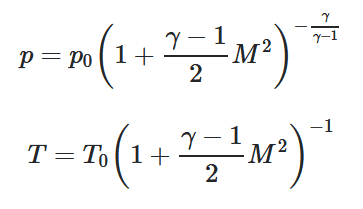

No one here should be using Bernoulli's equation, the equation ##u_1 A_1 = u_2 A_2##, or the Darcy-Weisbach equation until they've proven the flow to be incompressible. This is a compressible flow in at least some portion of the flow field, so you need to determine where and use equations valid for compressible flows. Luckily, the assumption of constant upstream pressure and an isothermal reservoir will help you considerably.
I asked about hole shape because it is important in determining the exit Mach number and the pressure required to choked the flow. If your hole expands at all after its narrowest point, you can choke it with much less pressure ratio than just a straight hole, but it sounds like your hole is most accurately modeled as a straight hole.
Because this is choked (as you have correctly suggested), you automatically know the Mach number at the narrow point (1) and the mass flow rate out of the hole depends only on the upstream total pressure and temperature, the cross-sectional area of the hole, and gas properties. You also know that, as a Mach 1 flow, compressibility is important, so you need to use equations suitable for compressible flows. I would suggest assuming isentropic flow here so you can use those relations, which will give you an alternative means for determining the Mach number upstream of the hole based on the area ratio of the pipe and hole.
The Mach number will be quite small (about 0.006), so if you want to include friction, you would therefore probably be justified to use the incompressible formulae. This will probably remain a decent approximation since friction will tend to increase the Mach number of a subsonic flow, i.e. it would be even lower further upstream. Fanno flow is the appropriate means of calculating compressible flows with friction, though it's likely to match Darcy-Weisbach fairly well at these Mach numbers. If you decrease the area ratio, though, all bets are off on that.
