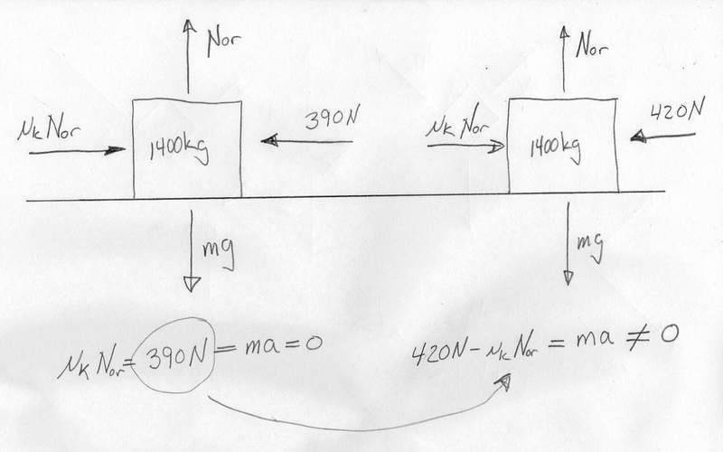

a) I said that: [itex] Work=[(140N \times 3) - (130N \times 3)] \times 100m=3000J<br /> [/itex], but I'm unsure if I correctly calculated the average force. My thinking was that the car was just moving with 390N of force (130N multiplied by 3 people), so it had no net force and was in constant motion. Once the extra 10N per person of force were applied, the car moved at an accelerated rate, so the net force was 420N-390N=30N. I can't figure out if I'm overthinking this or not.
b) I can't figure out how to get kinetic energy without velocity [itex](KE= \frac{1}{2}mv^2)[/itex]. I can find the CHANGE in kinetic energy (work), but without knowing how much KE the car had before the 100m stretch of road I can't figure it out.
c) If I can get KE, I can easily solve for v.
UPDATE: I asked one of my friends, and he claims that the work done in part a (which he thinks I did right) is ALSO equal to the kinetic energy in part b. I'm not sure if that's true because the car IS moving, so it has some KE even before it is pushed with the additional force over the 100m road.
Am I correct in assuming the total KE has to be greater than just 3000J, or would the motion of the car before the 100m not be considered a factor in this problem?

Also, I got the homework back, and you're right about (a). The work done was 320N, but I'm just having a bit of trouble with the conceptual part of it.

The implication of the "just keep the car moving" section [in red above] is that the car will move with basically zero velocity - a real conundrum. Having got the car the 100m, the amount of work done would have been 390 x 100 [force by distance].
Fortunately they apply a greater force - and thus do even more work than that.
The net force you correctly calculated will result in an acceleration of this 1400kg car - and over a distance of 100m, you could use the usual motion formulae to calculate the speed when the car reaches the gas station. [answer to part (c)] and thus calculate (b)
Alternately, the 390N force [doing 390 x 100 J of work] would get the car there with "zero" speed.
The extra work done by the 420N force will be the kinetic energy of the car (b) so you can then calculate (c).
