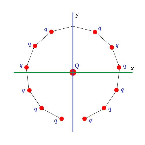

I tried with 5 sided regular polygon, removing one charge in the corner and adding graphically all force vectors I got net force vector directed toward missing charge. The same must be applied with 13 sided regular polygon without adding all vectors, from the figure we see that there is a symmetry represented by blue axis, forces from left and right sides cancel each other, so [itex]Q[/itex] should move toward the missing charge, because of gap between charges (and because of the more dense placement on the south side ?). The magnitude of force on [itex]Q[/itex] is [itex]\frac{1}{4\pi\epsilon_0}\frac{qQ}{r^2}[/itex] where [itex]r = r_1 + r_2 + ... + r_{12}[/itex]. Is everything ok ? Any corrections ?
Diagram of 13 red charges labeled q placed evenly on a circle, with a larger red charge labeled Q at the center of the circle on the x-axis, blue y-axis and green x-axis drawn through it.
  • Diagram of 13 red charges labeled q placed evenly on a circle, with a larger red charge labeled Q at the center of the circle on the x-axis, blue y-axis and green x-axis drawn through it.
I already know answer from the solution manual :
Boxed Coulomb force expression 1/(4πε0) · qQ/r², with an arrow labelled pointing toward the missing q.
I want to get this answer with the help of logical reasoning without using any geometric properties of adding all vectors.
Ok, but I said instead of removing a charge. What, equivalently, could you add?
I have an explanation. When 13 charges were present the system was balanced, the applied force on [itex]Q[/itex] from any charge is [itex]\frac{1}{4\pi\epsilon_0}\frac{qQ}{r^2}[/itex] this is a force to maintain equilibrium, after removing charge system becomes unbalanced, so the net force points toward the missing charge and is [itex]\frac{1}{4\pi\epsilon_0}\frac{qQ}{r^2}[/itex].
add charge(s)... but where ? I'm interesting where you're pointing me.
If you have a charge q at point P, what charge could you add which is electrically equivalent to removing the charge q?
Opposite to it.
Quanta said:
Opposite to it.
Yes, add a charge of -q at P. We know that the q charges balance each other at the centre, so what is the effect there of adding the -q charge?
System will become unbalanced and ##Q## will move toward the ##-q##.
Assuming Q and q have the same sign, yes. But what is the magnitude of the force?
##Q ## and ##-q## have different signs, there will be attraction force between them with magnitude of ##\frac{1}{4\pi\epsilon_0}\frac{qQ}{r^2}##.
Yes, except that you cannot say what the signs of Q and -q are. It could be that Q is positive and q is negative. Then Q and -q will have the same sign. However, you can write that there will be a force of attraction of ##\frac{1}{4\pi\epsilon_0}\frac{qQ}{r^2}##. If Q and q have the same sign then Q and -q will have opposite sign, so it is indeed attraction; if Q and q have opposite sign then the force will be a repulsion, but that's ok because now ##\frac{1}{4\pi\epsilon_0}\frac{qQ}{r^2}## will be negative, and saying an attraction of ##\frac{1}{4\pi\epsilon_0}\frac{qQ}{r^2}## is the same as saying a repulsion of |##\frac{1}{4\pi\epsilon_0}\frac{qQ}{r^2}##|.
