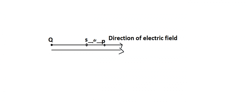

Consider a point charge Q placed at point O.Consider any point p in the field of the Q.Charge q is placed at point p.Charge q is then moved from point p to s the distance i=between p and s is dr.Calculate work done.
y
##dW=##-##F^→.dr^→##
Now what I don't understand is why my book takes F is equal to ##E^→.q##
I mean it moves by external force not the field force.Applied External force has nothing to do with force of electric field.

Yes, but how do you know how much external force to apply to move the charge away from Q?
BTW, F = qE should be lurking somewhere in your chapter on electrostatics.

Do you want to calculate the work done by the electric field on the point charge as it is moved? Or the work done by an external force against that field in order to move the point charge?
Assuming that the point charge starts and ends at rest then the Work Energy theorem has something to say. The work done by the one and the work done by the other must add to zero. The other will have the same magnitude and opposite sign.
So, up to sign, it does not matter which one you calculate. Pick the one that you can calculate from the information at hand.

The book has chosen to calculate the work done by the field. The force by the field on the charge is obviously given by the above formula.
It does have something to do with it. As above, the applied force (averaged over distance) must be equal and opposite to the field force.

By the work energy theorem. The integral of force times incremental distance adds up to work done. If we assume that no kinetic energy is gained or lost then the total work must be zero. So the integral of the field force over the path must be equal and opposite to the integral of the external force over the path. So their averages (over the path) must be equal and opposite.

If you want to move the charge slowly (i.e. without accelerating it significantly) or if the charge is of negligible mass (like an electron) then the external force must be essentially equal [and opposite] to the field force.

In the equation f=ma, f denotes the total force. It is the sum of all of the individual forces on the body.
If f=ffield + fexternal, if we know that f is zero and if ffield = 324.5 Newtons, what is fexternal?

Please stop responding multiple times to the same posting. It is annoying. I am no longer certain what point you are trying to make. Work done is intimately related to force applied.
If the net force is always zero then the work done will clearly be zero regardless of the path traversed. That follows trivially from the fact that the integral of zero is zero.
If the work done is zero and the path traversed is of non-zero length then the net force will average to zero as long as we do an average over distance. That follows trivially from the definition of the suitable average.
So pick one -- force or work. Which one do you want to talk about? What question do you have about it?

When speaking about "Work" we have to specify the force that does the work and the object on the work is done. So the question in the OP is meaningless, as it does not specify the force.
It can ask the work done by the electric field on the charge q while it moves from p to s. Or an external force can be specified and the work of that force can be asked.
