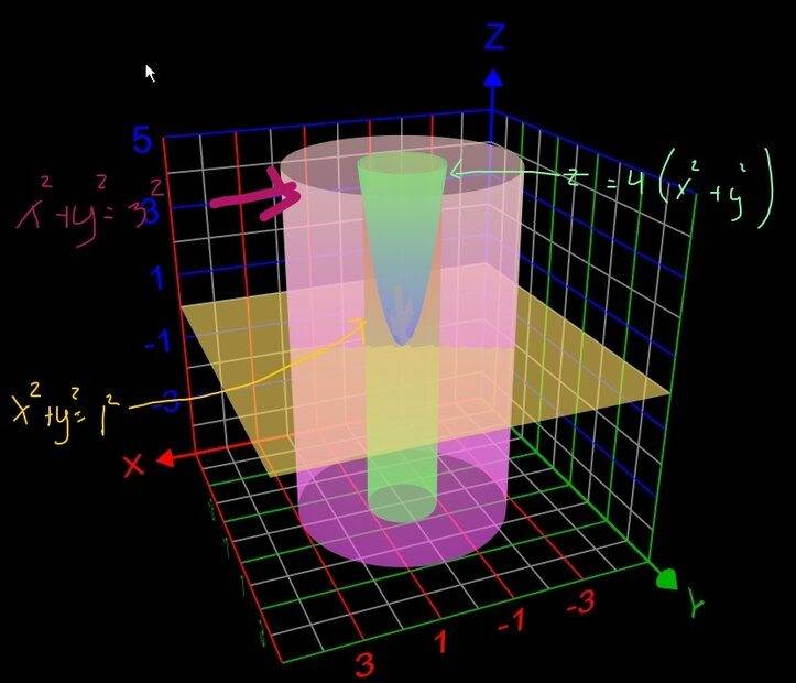

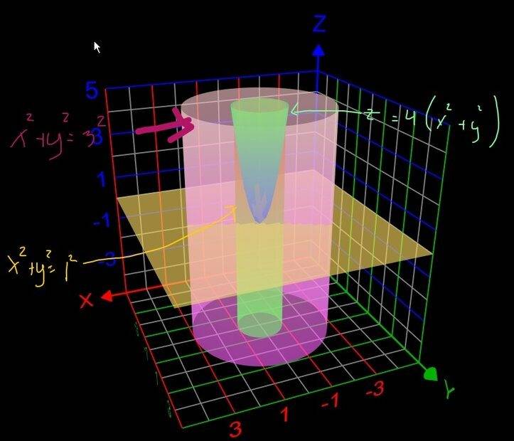

This is what I am getting as far as the sketch. The paraboloid does indeed touch the origin, and then the surface z=0 is shown as a plane at well z=0. so from z=0 to z=4(x²+y²) is the first integration? In other words does the set up look like 4(x²+y²) dydx? and the first integration is from x²+y²=1² (bottom) to x²+y²=3² (top)?

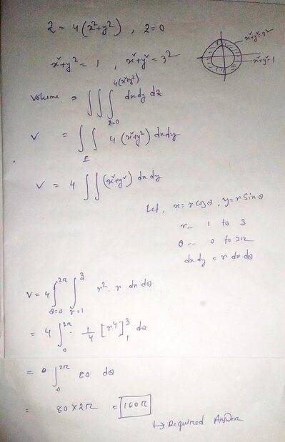

I suggest you look at cylindrical coordinates and figure our the range for ##r## or ##\rho##, whichever you use, for each value of ##z##.
Wow, nice sketch! What software package did you use to do that?
Normally I use autocad. But this is a simple piece of software you can easily get for free. You can get it on Microsoft Store and it's called Graphing Calculator 3, there's a free version and a pro version.

As for this question. This is what I came up with.
