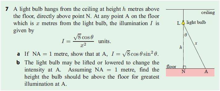

rshen5
i have no idea how to start
welcome to pf!
hi rshen5! welcome to pf! :smile:
(have a theta: θ and a square-root: √ :wink:)
show us what you've tried, and where you're stuck, and then we'll know how to help …
start with part a :smile:
you have any idea where the 8 came from ?

well.. i know I am completely wrong, cause i don't even know what "I" is..

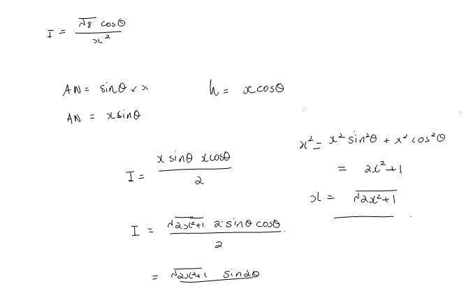

(you don't need to know what I is, you only need to know when it's a maximum! :rolleyes:)
why are you bothering with Pythagoras?
you've found that AN = xsinθ, and you know that AN = 1 :smile:

recall from elementary trigonometry that
1+cot(t)^2=csc(t)^2
you got a little carried away
you wrote AN=x sin(theta)
also AN=1 so x=csc(theta)=1/sin(theta)
you can write I in terms of theta by substituting x=csc(theta) into I
x^2=x^2cos(theta)^2+x^2sin(theta)^2
reduces to the un helpful
x^2=x^2
not x^2=2x^2+1

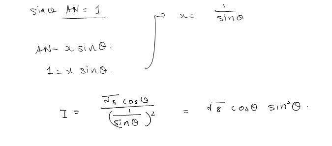

Thank you thank you ~~
gee that was easy.. (what was i thinking)
but does anyone know how they actually got the equation? just curious :-p
