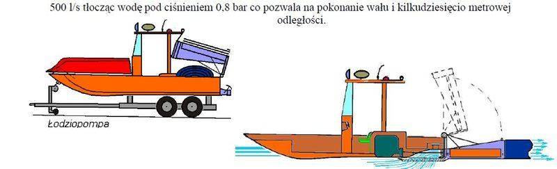

Polish firemen use small flat-hull motorboats equipped with special diffusor shaping the stream of water, which may be lowered to the propeller. They were used during floods a year ago not only to drain flooded areas and streets of flooded towns, but also to improve flow in channels, narrows and gaps under bridges. Single such boat pumps 0.5m3/s at high speed. I guess ordinary boat without such diffusor is less efficient, but on other hand may pump more water at lower speeds - which is better on large slow river.
