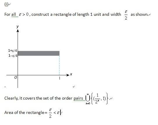

Yes, it does say for 'some k'. That's a little ambiguous. If it means for a fixed k, then it's basically the same as the first problem. Might be worth asking about. For the first one think about a partition that includes your f=1 points but is very narrow around each point. You are going to want to show you can find a partition such that the lower sum is zero and the upper sum is as small as you like. In the same spirit as the zero content proofs.
(i) Is this going to work?
