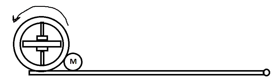

This is a purely experimental idea which I would like some help understanding A) whether it can work and B) how best to understand the mechanics of the act.
Firstly, my limited understanding of gyroscopes is that a stable gyroscope will (effectively) attempt to remain at the same angle if it is subjected to a force - as evidenced when people balance gyros with their centers of mass well off the balance point.
The following idea works in my mind, and I'm curious as to whether it does in practice:
We start with a lever, which is lying horizontally with a hinge fixing it at the end (preventing twisting actions, only allowing up & down movement). At the freely moving end, there is a motor which rotates a bed in the same axis as the hinge - so if the lever is lifted, the motor can be used to keep the bed level, or rotate it further, as I expect would be necessary. it can rotate freely in the same axis as the fulcrum, and is powered. Then a gyroscope is mounted (with a vertical axis of rotation) on the bed and spun up to a high speed, with a motor to keep it going.
With this set up, the motor is then activated to try and tilt the gyroscope downwards. The gyro resists this motion, causing the lever to lift up (and a corresponding drop in speed from the gyro, as energy is conserved).I first thought about this years ago after mucking around with a power ball gyro arm strengthener, and feeling the pull on my limbs as I attempted to twist the gyro around. I never thought it would have any practical application, but now I have an idea and I would like to know if there's any scope for me experimenting with this, or if my thoughts are all way off!

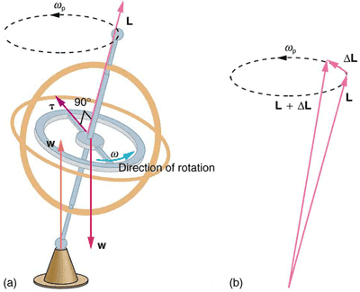

Some research has given me examples of precession, where a force is generated to make the gyroscope rotate around the vertical axis instead of falling down, but everything I can find relies on the gyroscope being free and untethered, and I can find very little to do with moving things using gyroscopes.

I have made some very bad sketches on paint, as I haven't access to a scanner!
This is the premise - the gyroscope is at one end and is rotated by the motor (M) as per the arrow above. the right hand side is fixed by a hinge to a large, immovable object (here being the ground).

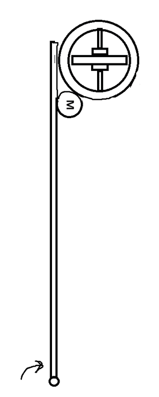

would this action cause this to happen:
(please excuse my terrible paint skills!)
I suspect the gyro would end up tilted slightly as it will not perfectly resist the motion, but this is the premise.

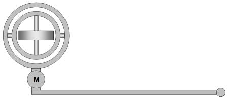

I would say in order to make that working you would need an additional axis parallel to the lever, that the gyroscope axis can rotate around.
Edit: Maybe something like this

If think the motor torque on the gyro should be perpendicular to both: the spin axis and the desired rotation axis for the spin axis.
