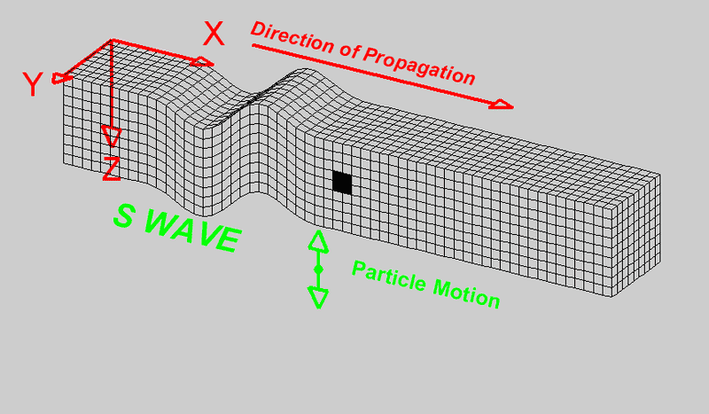

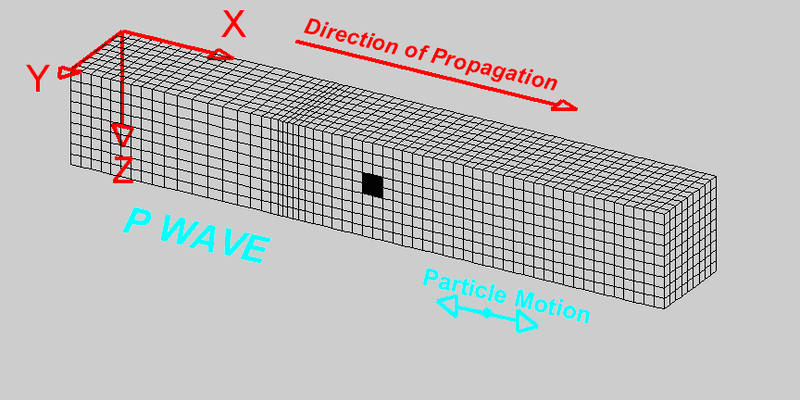

yes they all propagate forward but the particle motion for a shear/traverse wave is perpendicular to the direction of propagation
But I'm sure you already knew that :wink::-p
longitudinal -- compressional wave
shear / traverse wave ... one type
another type
The reason I mentioned it was that your post may be read as "transverse waves do not propagate in the longitudinal direction".
yes, I could have worded it better :smile:
View attachment 111637shear / traverse wave ... one type
another type
unfortunately they won't do their animation after uploaded
Dave

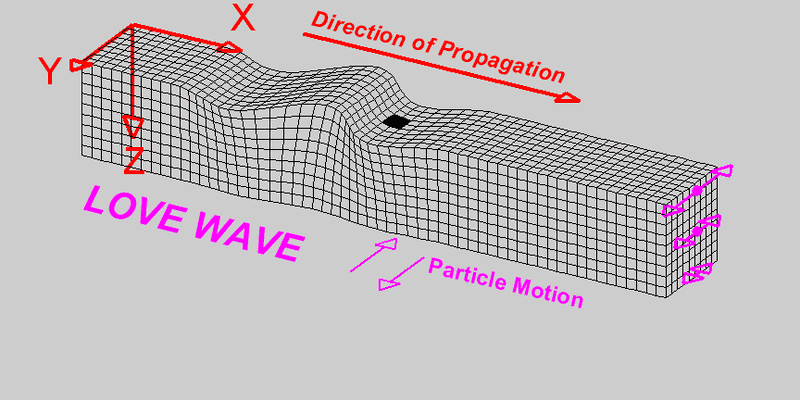

The LOVE wave seems to be just a transverse wave where the plane of oscillation is horizontal Is there more to it? Where are these types of waves generated?
