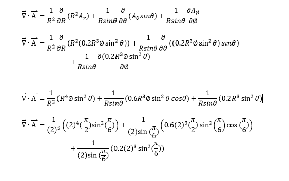

I attempted to solve the problem. I would like to know if my work/thought process or even answer is correct, and if not, what I can do to fix it.
I am given:
Calculate the divergence of the vector field :
A=0.2R^(3)∅ sin^2(θ) (R hat+θ hat+ ∅ hat)
[/B]
The equation I used was the divergence of a vector field in spherical coordinates:
The file is attached:
My final answer is 3.60.

What does your notation mean? What is ##\hat{R}##. What is the difference between ##\theta## and ##\hat{\theta}##, and between ##\phi## and ##\hat{\phi}##? I can guess, but why should I need to, and maybe my guess is wrong. Finally, which of the two common forms of spherical polar coordinates are you using? Some sources use ##\theta## as the polar angle (latitude) and ##\phi## as longitude, while others choose the exact opposite convention. Both appear in this Forum from time to time.
