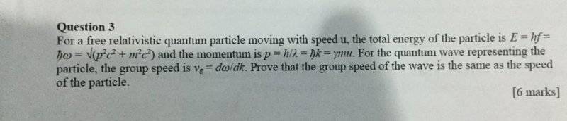

I posted this question on the quantum forum but it got deleted saying that I was cheating on homework
I only need a simple yes or no

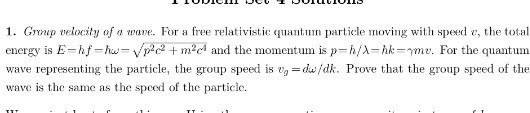

This is the original question
This is the question my teacher gave
As you can see in the total energy formula is missing an extra square. The original question has c^4 but the one that my teacher gave has c^2
Can both of these give the same final answer which is supposed to be u
All the equations are given in the question

I don't need anyone to tell me how to do the question
I have done both versions and the textbook question resolves to final answer as u
But the one my teacher gave doesn't end up. I did both side by side and I find the extra c^2 which is missing plays a huge role in resolving the final answer
I just need a yes or no. Please
If a formula has two terms that are added and the dimensions (or units) for the two terms are not the same, then the formula cannot be correct.

Thank you very very much
I have been doing this question all night and only now realized that they were different I had previously done this question from the text
But last night I just couldn't get the ends meet
Finally I did both side by side and found the typo
But I was just thinking it may still work out
But even then the ex didn't get the correct answer
So I just wanted to check
