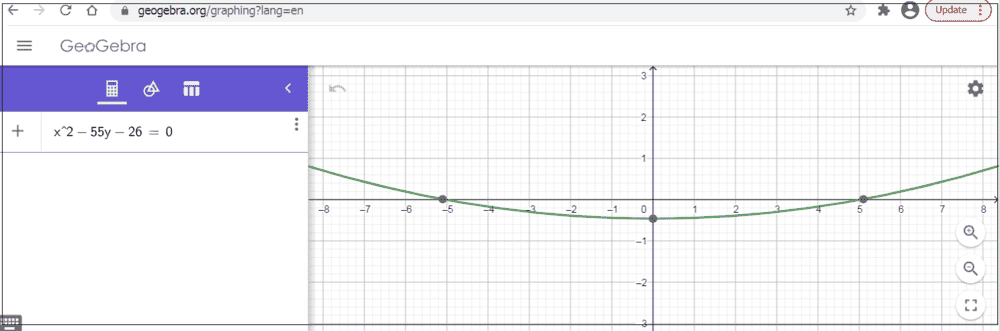

Solve the equation: x^2-55y-26=0.
None.
I know that the answer is x=46, y=38. Because 46^2=2116 and 55*38=2090, and 2116-2090=26.
But the question is, how to find out x and y? I just cannot think of a way to solve this type of problem. If this equation only has one unknown variable, then I would know how to solve for it. But this equation has two.
... or ##(9,1),(24,10),(31,17)## and infinitely many other integer solutions, and infinitely many real solutions, since its graph is a parabola.
This shows that there is a massive lack of information, if only ##(46,38)## is considered a solution.

There are many ways. The simplest, by simplest I mean, not using calculus and above. Is to solve the equation you have for y, then complete the square, so that you graph/visualize the parabola.
You can also find the x- intercept (set y=0), then solve for x.
