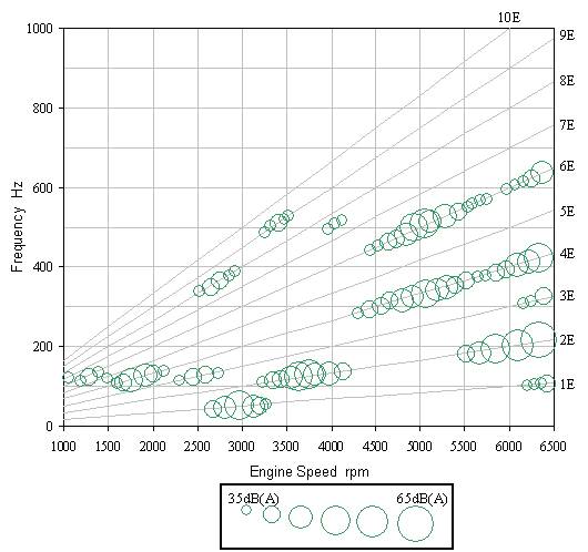

Let us consider the plot of campbell/ stoke diagram.
Campbell diagram is a plot of natural vs exciting (forcing) frequiencies.
It predicts the resonant frequencies and the corresponding modes when resonance occurs.
On the horizontal axis in the Cambell diagram, I ahve the engine speed starting from zero at the left to maximum speed as I move towards to the right on the horizontal axis.
On vertical axis I have the frequencies.
I know how the exciting force varies which are the lines coming from the origin of the Cambell diagram.
Coming from the vertical axis are another series of lines representing natural frequencies of various nmodes (flexural or torsional modes). Here, I mean naural because it is the frequency of a system based on its own characteristics NOT the forcing characteristics. RIGHT?
when theese lines coming from vertical axis intersect with the lines from origin we get resonance.

In computing the natural frequencies, shouldn't we include damping BOT due to FRICTION as well as structural damping ?

Here is your Campbell diagram :-
On the horizontal axis in the Cambell diagram, I have the engine speed starting from zero at the left to maximum speed as I move towards to the right on the horizontal axis. On vertical axis I have the frequencies.
Yes...
Yes...So...
Ok.
Here, I mean natural because it is the frequency of a system based on its own characteristics NOT the forcing characteristics. RIGHT?
Right..
when these lines coming from vertical axis intersect with the lines from origin we get resonance.
Yes...
See my previous reply and also the second reply by JHamm. When a body executes free vibrations , then the vibrations made per unit time gives its natural frequency. Free vibrations are the vibrations which a body executes in absence of outside interference i.e in vacuum or deep space.
In computing natural frequency we neglect any kind of damping , be it damping BOT due to FRICTION as well as structural damping.
If we include damping then we will have to compute friction of air , etc which are perhaps very difficult to. Also the frequency of a body will be different due to varying interference.

The "natural frequency" is defined as the frequency that would present itself in the absence of damping. A real system would have damping, so the frequency would be different from the natural frequency.
So, how will the prdiction of resonance be correct if we neglect damping?
If the damping is weak then the frequency will be close to the natural frequency. As the damping increases then so does the deviation. If the damping is too large then the natural frequency becomes relatively unimportant, but then again the system won't do much "oscillating" either.

Suppose you are driving a bike and at a particular speed you here a loud sound. This is because the natural frequency of the frame of bike is equal to or is the integral multiple (you missed this point about resonance) of the frequency of the engine at that time.
But the question arises about damping , right ? Imagine that the vibration of bike frame is of very high velocity than the force constant applied by outside surroundings on it. So it nearly reaches its natural vibrations which matches with frequency of external periodic force of engine. This resonance is determined as nearest approximation. It is not 100 % correct demonstration but is enough to experimentally understand resonance.

Strike an odd piece of cutlery with a spoon. You will notice that at one particular force a very loud sound will be heard. This is because natural frequency of cutlery becomes equal to or is the integral multiple of the vibrations of the periodic external force of spoon.
If damping is very less , then you may predict resonance perhaps easily. As damping increases the prediction of resonance will perhaps become a lot difficult. You may then have to strike cutlery with much greater force for resonance to be predicted due to "unison".
Note that you will predict the resonance as nearest approximation which will not be cent percent correct demonstration. Perhaps it will be enough to fundamentally understand resonance.
