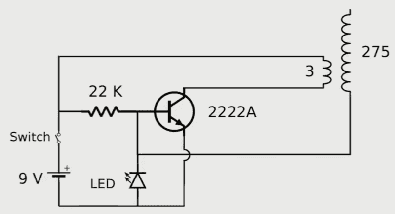

hello guys
i saw a slayer exciter circuit , witch is the crude more simpler version of the tesla coil
and i made it , it works quite well but i have some questions.
some questions :
1 - how strong is the magnetic field caused by this tesla coil ? it can ionize neon gas , or argon ?
2 - i thought i would do some experiments with it and iam wodering can it cause NMR for water ?
3 - can it cause an observable zeeman effect i could detect with a spectrometer ?
any help !

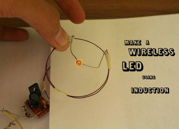

To observe the B-field at your frequencies, you could see how many turns of wire it takes to light up an LED. The E-field will not be able to light the LED, only the B-field piercing the LED coil will generate a differential current to light the LED. :smile:
https://cdn.instructables.com/F32/W36R/HZ6T96H4/F32W36RHZ6T96H4.MEDIUM.jpg
