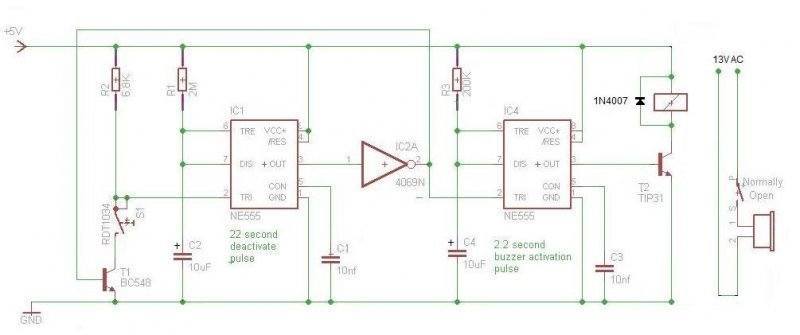

Hello, I remember a few decades ago I built a circuit with my dad using what I think was a 741 op amp and a 555 timer and a loose wire. When you'd touch the wire, an LED would light. Then it took 30 seconds for the circuit to reset. I remember he said it was called a [logic] gate.
Present day, I have some stepkids that ring the doorbell like it's a fricken carnival ride - every morning. Even though I tell them to only ring it once, they are narcissistic and do not care about my piddly request.
I would like to build a logic gate and a timer that only allows the doorbell to ring once every 30 seconds. Here's my caveat. The voltage for the doorbell registers 13.4 VAC when you hold the button down. Can I still use the same kind of circuit (supplied voltage different of course) with a 555 to accomplish my goal?

yes that is very easy
The output from the op-amp and timer cct would drive a relay that would switch the AC voltage to the bell
do you still have the original cct from your dad ? I or some one else may be able to modify it
if not, could come up with a replacement :)

Hi Freddythunder
sorry for taking a couple of days, I'm just out of hospital and also battling a dose of the flu
here's a circuit that should do what you are after
you can derive the 5V rail from the 13VAC using a bridge rectifier a 1000uF electrolytic cap and a 7805, 5V reg
( or a little higher a 7808 - 8V or a 7810 - 10V would be OK)
breadboard it first and see how you go and report back
cheers
Dave
cheers
Dave
Maybe you could simply power the bell from a large capacitor, which is itself charged via a resistor giving a 30 second delay.
