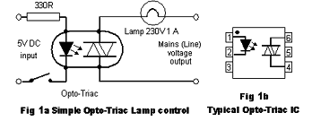

I'm trying to use a triac to turn on mains power (fused) with and opto-isolator but what is a good method to turn it off, high on low off, I'm not trying to short the mains or use a bjt on high power ac. if someone could give me a hint i'll figure it out from there.

You are asking how to make a solid state relay.
Circuit schematic of a simple opto-triac lamp control: 5V DC input through a 330R resistor and switch drives an LED, which optically couples to a triac output switching a Lamp 230V1 A on mains voltage. Beside it, Fig 1b shows a typical opto-triac IC pinout with pins 1 to 6.

Did you look at figure 5,6, or 7 in the moc3020 datsheet you linked to?
Or, try figure 12 in the datasheet for the part you just posted a circuit for.
https://www.fairchildsemi.com/datasheets/MO/MOC3041M.pdf
It shows how to use the optically isolated driver to drive a power triac, which is what you need to do.

although I haven't read about triacs in a while I know their not what I want to use, half conduction was not what I was looking for, plus theirs still the problem with turning them off and just briefly looking at the datasheets and tuts about them they come with to many problems that I just don't feel like dealing with right now. this may be a dumb question but what do those figures have to do with anything?
? half conduction ? turn them off ?
maybe you need to read a little about triacs.
They're bidirectional.
They turn themselves off, just remove drive and wait for next sinewave zero crossing.
If you want to turn it off mid-cycle you'll have to add a commutating circuit.
